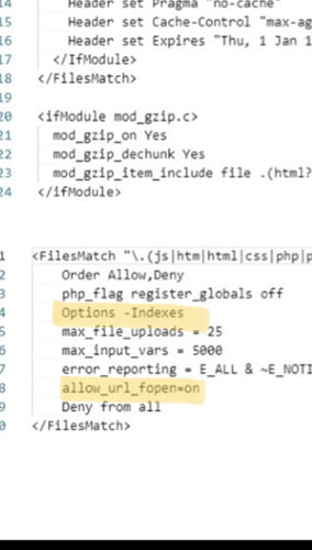

I’m creating a Gibbon SIS portal for our school, and am having trouble getting my .htaccess files (Uploads and Htdocs folders) to work:
Changes I make to these files doesn’t seem to affect the site for good or bad. Any suggestions?

Changing PHP settings through htaccess rules requires using the php_value or php_flag options (like you do with the register_globals). Just dumping the PHP settings into the .htaccess file isn’t valid code. I would fully expect this code to just crash your site. Seeing how it doesn’t crash, I strongly suspect the code is never actually reached.
Checking your site, the .htaccess file where you’ve added this settings is located in the uploads folder. That means these rules are only executed when you try to access the /uploads URL on your site. The rest of your site, which is where all the PHP requests go through, do not have these lines, so even if the configuration lines do work, they’re not working because they are in the wrong place.
Actually, this might be the reason why the “Uploads folder not publicly accessible” check may be failing. I’m guessing the entire folder is unreachable because the folder contains invalid .htaccess rules. If that check expects to see a 403 Forbidden error, but it receives a 500 Internal Server Error error, or a 302 redirect to the 500 error page, that could be causing that check to fail.
So, in short:
  • Please restore the .htaccess file in the uploads folder to the original contents, the current contents do not work.
  • The allow_url_fopen setting is already enabled. But we’ve configured it as On, not on. PHP interprets these settings as being the same, but your software does not, which is a bug in the software.
Thank you both for the insight. I’ve restored the .htaccess file in the uploads folder to the original contents, and updated the .htaccess file in the htdocs folder to the following:
I know that Gibbon is reading this file, since I was able to change the values for max_input_vars and max_file_uploads to 5000 and 25 respectively. I will talk with the folks at Gibbon regarding the bug you mentioned on allow_url_open. As for the “Uploads folder not publicly accessible” check, any further thoughts? The file permissions are set for 0755.

Neither 777 nor 750 seem to affect it. I thought the Options -Indexes line might do something, but adding that (or commenting that out) has no impact on the error check either:
