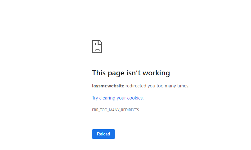

Please help, just a newbie to web deployment.
First of all, I am using domain.com as my domain provider and infinityFree for my hosting. Everything was working smoothly from changing my DNS nameservers to infinity’s nameservers and my site was totally fine at first until I just recently encountered configuring my SSL (self signed certificate) in my control panel then everthing went difficult for me. Given that Self Signed Certificate is not removable and my site became forbidden to access because it was forcing my site to use Https. So that’s when I started using Cloudflare for free SSL Certificate and what I did is I changed again my DNS nameservers (from domain.com) to Cloudflare nameservers and deleted infinity nameservers as the previously registered. After that, I registered the infinityFree nameservers into my CloudFlare DNS Records as showed in image below…
And followed this instruction - Docs - InfinityFree Forum. I pointed my domain to my hosting IP using A Record via CloudFlare. Now I am currently experiencing this… as shown in the image below

Reverting it back to where it was working is nice idea though, but it will just force my site again going to https, back to forbidden access again. How could I prevent that? I really regret that I’ve configured the Self Signed Certificate (sigh) and now it doesn’t want to be removed so I just leave it empty.
