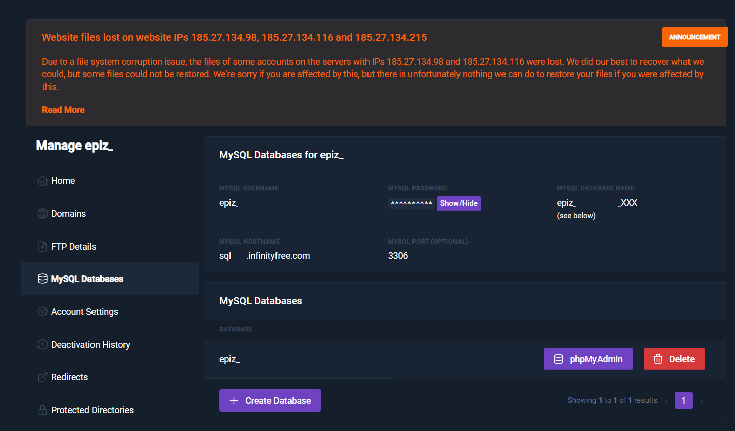

What I see as MYSQL PASSWORD in dashboard is different than DB_PASSWORD wp-config.php…

Normally, your account username and password are also your MySQL username and password, meaning you have one user/password for all databases.
Softaculous muddies this a bit by creating its own users and passwords. If you’re migrating websites, you probably can’t use those credentials as they only have access to the specific database they were created for, not all databases in the account (I think).
So you’ll want to remove all the existing database credentials and enter the username, password, hostname and database name shown in the client area. Please don’t go mix and match credentials, it’s going to end badly.

You’ll need to replace your credentials with those from the client area’s “MySQL Databases” section:

That username is incorrect. It should be epiz_34093412.
Please make sure to use the EXACT credentials shown in the client area.

I have no idea why dashboard credentials work with old database but not with new database but it seems to work.

The MySQL credentials in the client area should work with all databases on the account. But you do need to use the right credentials.
