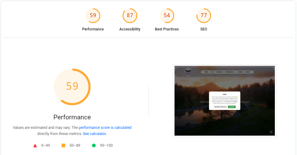

Hi! I suggest you start analyzing the performance of your website with actual data. You can start with Google’s PageSpeed Insights tool. You can view the results here.
If I were you, here’s what I would do. I would try minimizing the total number of render-blocking requests first. I would categorize them one by one based on importance and urgency. Some resources being requested on the homepage do not even need to be loaded right away and are not critical enough to break the website’s functionality. You need to “decide” which assets (i.e.: image, font, stylesheet, script) are needed during the initial page load and which of them are okay to be loaded afterward. Use the data gathered from Google PageSpeed Insights. By doing that, you can reduce the overall page loading time by 1–2 seconds.

Doing a speed test with Pingdom tells me a few things: Website Speed Test | Pingdom Tools
Firstly, the “wait” time for the actual page itself is 5.7 seconds. That’s a lot. That’s time time it takes for the PHP code on your website to execute. That could be due to Elementor or another plugin. A caching plugin can help with this.

I appreciate your reply. I have used and got the same report from Google metrics and whatever you are saying is absolutely correct.

On the PHP side, I’ll add a caveat to my earlier recommendations: the PageSpeed Insights result that @JavesPotato shared showed a First Contentful Paint of 3 seconds, which suggests the PHP processing time might not actually be as bad as Pingdom made it look. So focusing on the large images will probably see the most clear benefit to page load time.
