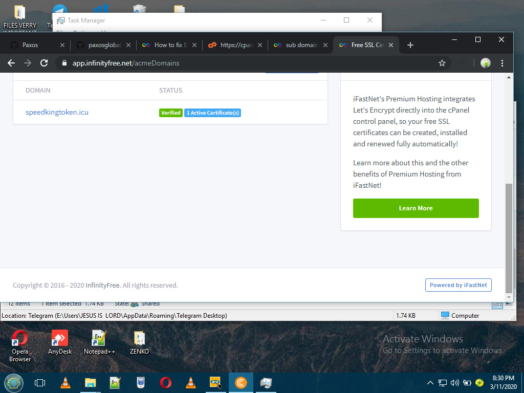

It is working in the Main site not working in the forum like forum.site.icu

The main page shows SSL, https://speedkingtoken.icu/?i=1 Now everything needs to be forced to the https/SSL.
The forum is not SSL even though it has the HTTPS link on the homepage, clicking on it brings up the error page ERR_SSL_PROTOCOL_ERROR

I did it but it shows the error i put the .htaccess in the htaccess in the websitge b ut it refuse to work please help me to know how to fix it thank you alot
You need to install a SSL certificate for your subdomain too, but the Control Panel doesn’t have a function to do that. So you should configure Cloudflare for your domain instead to fix the SSL error on your subdomain(s).
