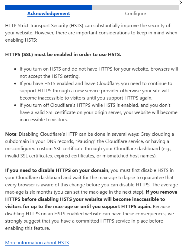

You are right
Keep mixing up with CloudFlares HSTS.
Well it may cause more pain if there is SSL outage
Well, technically there’s no such a thing called “Cloudflare HSTS”: Cloudflare also just implement the standard HSTS.
