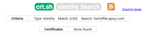

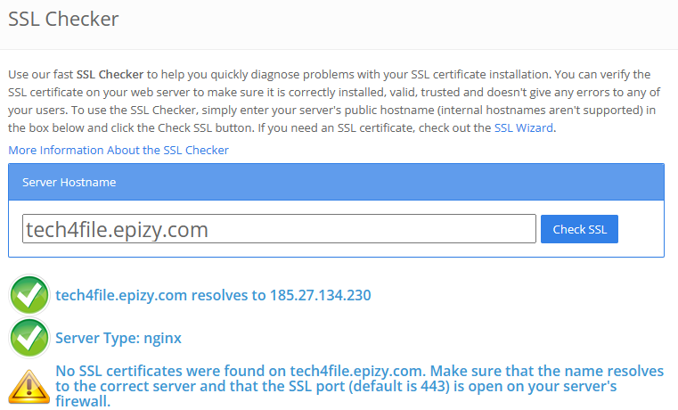

You don’t have a certificate installed:
or issued:
Since you have a redirection to HTTPS, I cannot view the website.
Keep in mind that you cannot use InfinityFree subdomains with Cloudflare.
To request and install a certificate, please follow the guide below:
