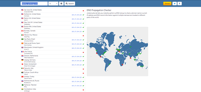

Some sites just said that the sign of whether the DNS propagation is complete is that the record is avaliable in every region by the way.

Sites like dnschecker.org heavily play into this with their “propagation map”, which is still not how it works. Although their actual checks aren’t that stupid, because they are actually querying public resolvers from various providers across the world. So they do give some idea as whether your site would be accessible from these providers.
But of course, dnschecker.org showing all green is no guarantee that your site works everywhere, because they only check the resolvers which they check. Other resolvers that they don’t check may still serve outdated data.
