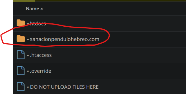

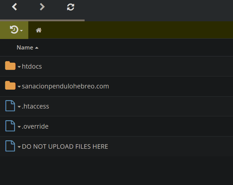

hello, how should i do that? Finally I have entered the folder sanacionpendulohebreo, inside there is an htdocs, and I have created there an .htacess with the lines of code from the tutorial.
Do I delete the other .htaccess that I created in the “htdocs” folder sibling of sanacionpendulohebreo? leaving only the .htaccess that is in the htdocs child of the sanacionpendulohebreo folder?

ok, i just put that in sanacionpendulohebreo.com / htdocs / htaccess file
is that the right path?
there is another htdocs folder at the same level of sanacionpendulohebreo.com (here I didn’t put any htaccess file)

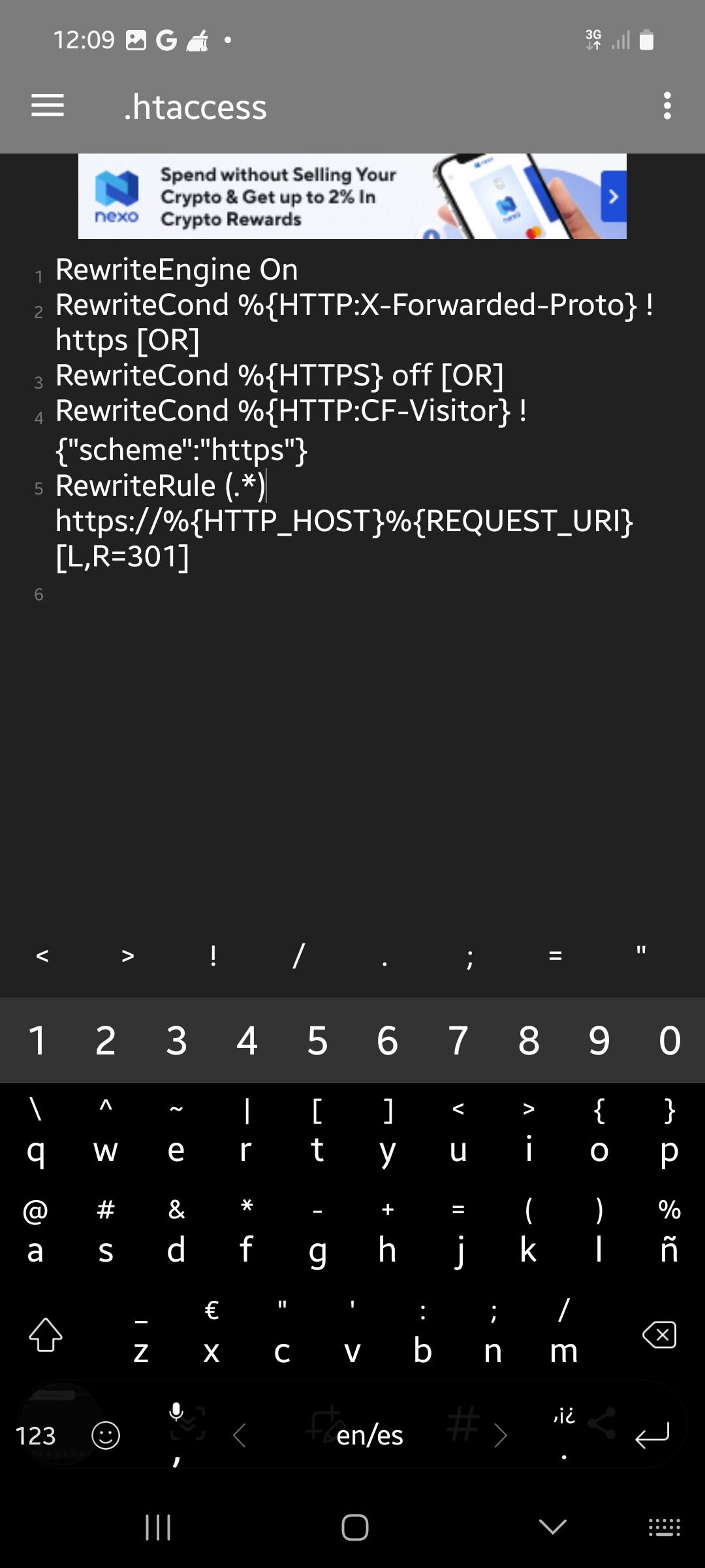

The .htaccess codes provided to you were incomplete. You need to have the line RewriteEngine On at the top of the file for the code to work.
OK done
Let’s see how it goes thank you
But for what I am seeing the problem still :frowning:
My path where I have my htaccess file it’s OK?
Currently I have
RewriteEngine On
RewriteCond %{HTTP:X-Forwarded-Proto} !https
RewriteCond %{HTTPS} off
RewriteCond %{HTTP:CF-Visitor} !{“scheme”:“https”}
RewriteRule (.*) https://%{HTTP_HOST}%{REQUEST_URI} [L,R=301]
Sanacionpendulohebreo.com /htdocs /htaccess
Currently it seems doesn’t work
