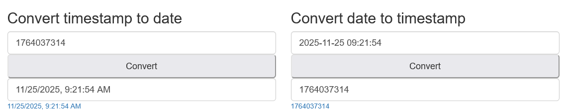

At phpMyadmin, when I run the query SELECT UTC_TIMESTAMP(); then, it outputs 2025-11-25 09:21:54.
The question is how can I accurately convert 2025-11-25 09:21:54 to timestamp value 1764037314, if only using MariaDB/MySQL query?
I need it to run like this (https://timestamp.online/):

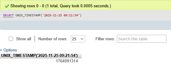

SELECT UNIX_TIMESTAMP('2025-11-25 09:21:54');
This query will return 1764037314 if your server’s timezone is set to UTC+8 (or the equivalent timezone where this conversion is accurate). The server interprets the date as a value in the current time zone and converts it to an internal value in UTC.

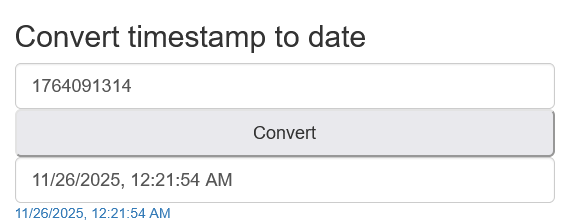

Strange, I tried to do as you instructed, but the result it returned was 1764091314, instead of 1764037314.
If you convert timestamp to date, it will be:
  • 1764091314 → 11/26/2025, 12:21:54 AM
  • 1764037314 → 11/25/2025, 9:21:54 AM (this is the value I expected)
