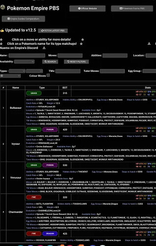

Hey everyone,
I noticed my site consumes a large amount of memory:
At times, I’ve seen it go up to 1.4 GB!
Is there anything I can do to help reduce the memory consumption? I’m aware that some browsers consume more memory than others but I’m looking at this from a site building perspective. I.e, have I used bad code or bad practice, can I reduce the memory consumption through the js files themselves.
Any advice would be helpful.

It looks like it fluctuates between 750-800 megabytes on my end using Opera GX, though that still isn’t ideal. The biggest contributor to RAM usage is going to be the high amount of Javascript code that page seems to be using. You may want to look into optimizing your code as much as possible, and try to only have the browser only use the Javascript that’s necessary at any given time. There isn’t a good one-size-fits-all answer to this, though minifying your code may be a good idea. However, I think a good first step is to try and analyze the code on that page to figure out where the high RAM usage is coming from so you know what to take care of.
The Developer Tools in your browser has a Memory tab. I have never really used it, but I would guess you could use it to analyze how exactly that memory is being used?
Thanks for the quick response and the suggestion. I’ve tried using the developer tools to take a deeper look at the memory tab. But in all honesty, not much of it makes a lot of sense to me.
Web development is still quite new to me so if there are any learning resources that you can recommend or spot any obvious javascript bad practices I’m doing then please let me know.

Thanks for offering a hand, here’s a description of what goes on behind the scenes of the website. (I’d prefer to show you the site but it’s currently suspended)
Essentially, it’s a Pokemon database of a non-profit fan game that I have helped build. The site is used to search for a particular pokemon to help players with their teambuilding strategies.
In fan games, the metadata of moves, abilities, pokemon and other game related info is stored in separate txt files.
These files are manually uploaded to the server as .js files and variables are assigned to each file. var abilitiesTxt for abilities, pokemonTxt for pokemon, movesTxt for moves etc etc.
The main premise of the site is to allow players to filter the database however they would like. I.e. pokemon with a specific type, pokemon with a specific move, pokemon with a specific name etc.
The problem I’m having is the site is using a large amount of RAM when viewing and I’m looking for ways (if any) to optimise that.
There are around 1068 pokemon, each pokemon has it’s own little table detailing the moves it learns as it levels, the abilities it has and other info assigned to it. Here’s a snippet of what it looks like:
I’ve taken some steps to limit daily hit rate by combining all the .js files together. (The pokemon, abilities and moves are put into one called DataFiles.js). I’ve applied lazy loading to the images/sprites.
The images themselves are uploaded on Google Drive rather than uploaded on the server itself. There’s a mapping mechanism that I’ve built where each pokemon ID maps to a specific Google Drive Image File ID so that the image belonging to that pokemon can be rendered. That mapping is stored in another .js file. The index.html calls all the .js files.
There is a caching mechansim whereby each .js file is written as “example.js?1.1” so the website caches on first load and when the metadata changes I then add 1 to the version of the js file I’ve made changes to so that a fresh copy can be loaded. These metadata changes occur once every 3 months usually. (example.js?1.1 becomes example.js?1.2)
In total there are 5 .js files, 2 .css files and 1 j-query file that the site loads each time. So not many hits are generated each time.
Apologies for the long-winded explanation, there’s only so much I can do whilst the website is suspended so I think the detail is warranted.
Based on that, if there’s anything that instantly calls out to you then please provide me your wisdom. When the site returns tomorrow, I will drop the link here again and you can have a look for yourself how the website is built.
Thanks for reading!

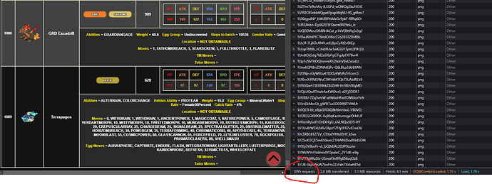

Not true
Just one visit to
will generate close to 1100 hits
Mind you, this is only for one page view
Ok, that’s really odd because I kept a watchful eye on the daily hits when I first implemented the image mapping mechanism and it wasn’t reaching that many when the page is loaded.
I recognize that as the user scrolls the lazy loading element will activate but my concern was on first load.

Managed to solve the memory consumption issue by adding a pagination mechanism to the site, displaying a max of 200 per page.
This reduced the RAM usage from a max of 1.8 GB to just 271 MB!
Thanks all for your inputs!
