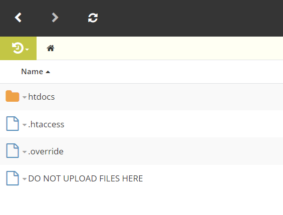

now i could login via online file manager but not filezilla
That’s because you messed up the account
See this???
No, FileZilla should still load without the htdocs folder, since it is the root folder, not the Home directory.
Try doing the steps above in the file manager then @anon52920867
Success!
