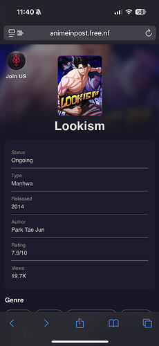

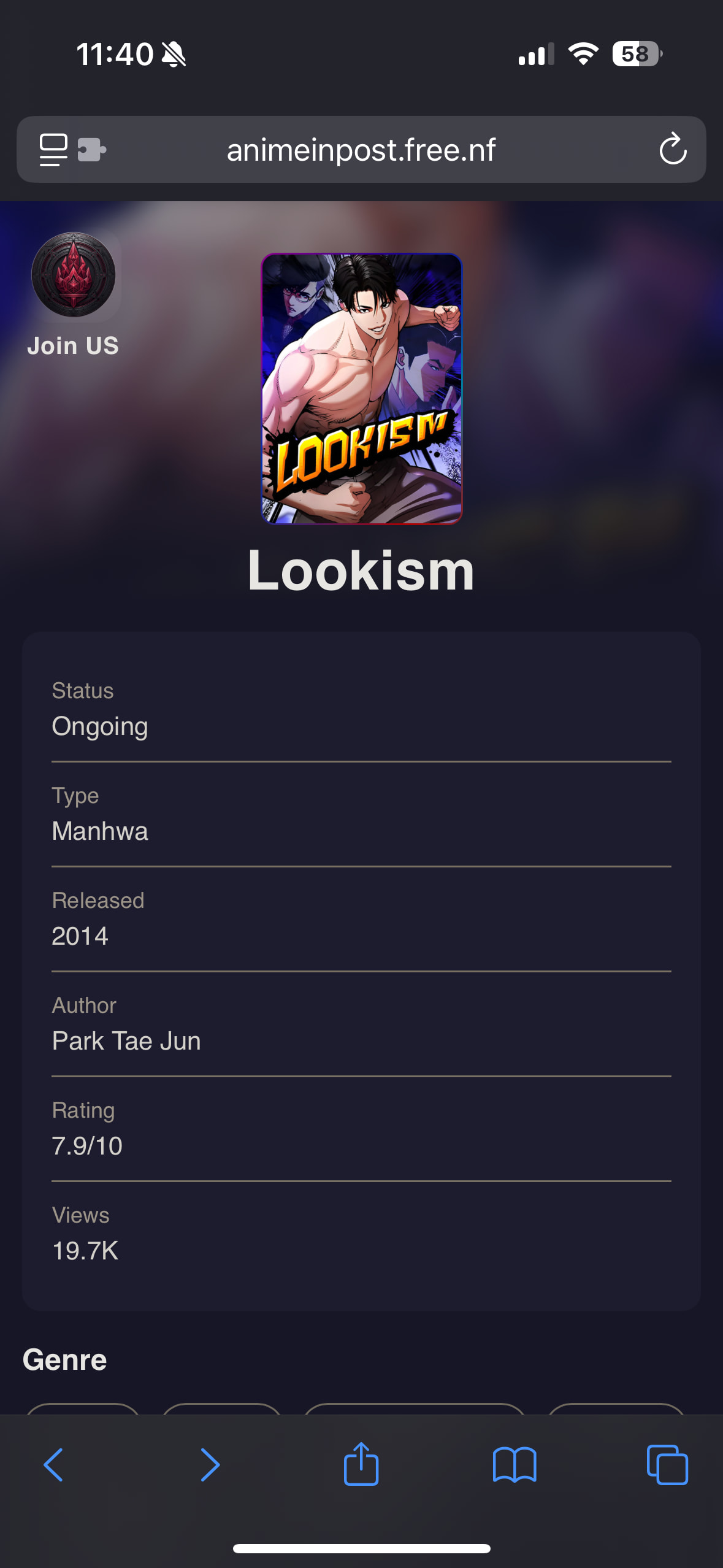

​I am experiencing an issue where Google Search Console is reporting a “Failed: Server error (5xx)” whenever Googlebot attempts to crawl my site.
​While the website loads perfectly fine for me in a regular browser, Googlebot is unable to access it. This is preventing my new pages from being indexed. I have already verified this with the URL Inspection tool for several pages, including:
