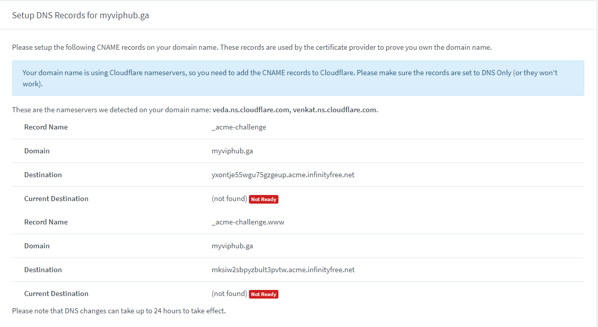

Okay so here on infinityfree I requested an SSL certificate, but says I need to set up the CNAMEs on cloudflare.
On cloudflare, I need to add the 2 records where cloudflare. type = CNAME, cloudflare.name = infinityfree.record name, and cloudflare.target = infinityfree.destination?
And also, if I scroll down, it already says I have a valid certificate installed on my domain, however, don’t I need to paste the private key and the certificate itself either here on infinityfree or on cloudflare?

No, You dont need to add anothr cert. The one provided by infinityfree is enough. Just make sure your account is on. It worked for me without creating another cert
I have made the 2 records on cloudflare, if I was writing sql now, I would say cloudflare.Type = CNAME, cloudflare.Name = infinityfree.RecordName, cloudflare.content = infinityfree.Destination.
I have set up both records in cloudflare like that.
It looks like you turned on SSL on Cloudflare. Like my guide says, this is not that secure (It is more secure than nothing). I would recommend adding the cname records, copying and pasting the text, and than changing the Cloudflare SSL to “Full”.
I have that on Full (strict).
Ah figured it out. I needed to click the proxied button. Didnt realise that was a button XD
For “Full” you need to add those CNAME record than copy and paste the keys.
