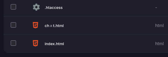

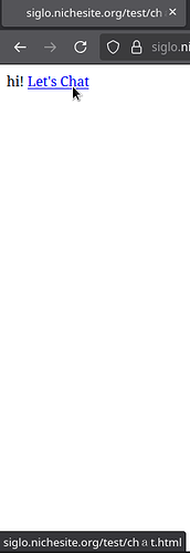

It’s a little disheartening but it requires just one tiny step over this roadblock. For ASCII-only keyboards, synonyms are the easiest and make most sense, “talk”, “call” or “text” all fit 4 characters.
If you are making the links yourself on your pages, and really wanted the word “chat“ without the trigger, you can use a unicode like U+FF41.
Or maybe if the URL is from a user-generated content, you have to set a custom filter to capture it turning it into “c-h-a-t”, “ch4t“, ”chat” or something before publishing.
