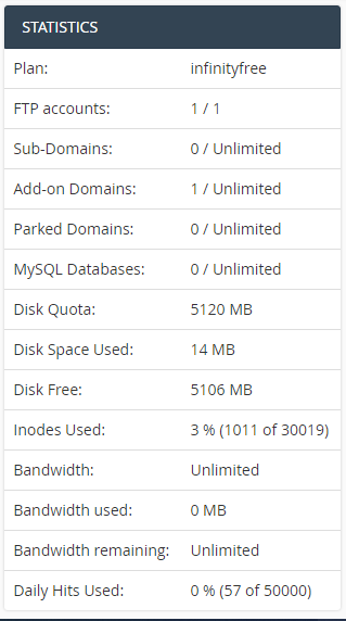

Hmmm,did your account hit any storage or inode limit?
Only admin can access your account…
no
Let’s wait for admin then
Yes, it looks like you hits the storage limit.
5120MB is 5.12GB, and the limit is 5GB. Removing some files will get you below the limit.

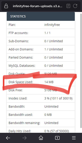

Sorry, I read that image incorrectly.
i don’t think so

@Greenreader9 look carefully
Only 14MB of storage is used.
