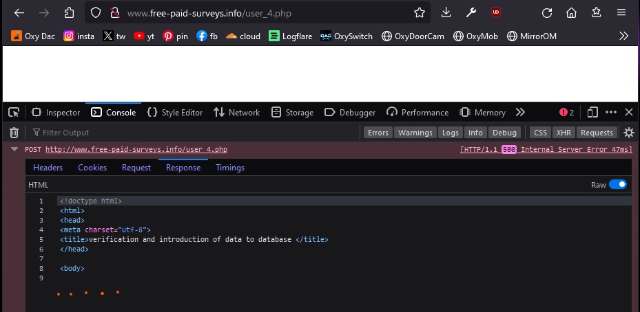

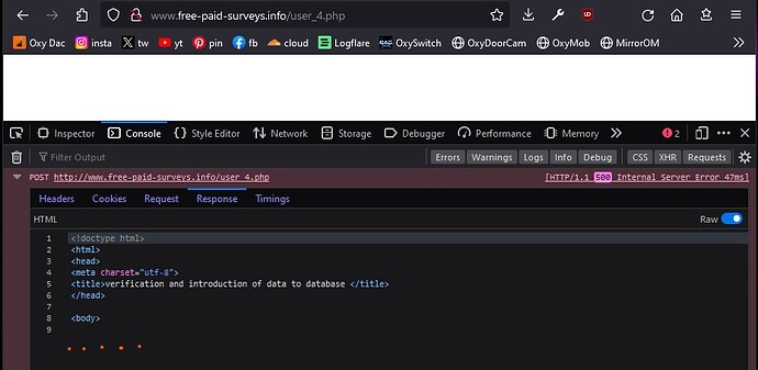

The page above is a form used by customers to sign up. The form is backed by a PHP script that stores customer’s data to a MySQL database created in my account at infinityfree.com . The script filters customer’s data then connect and stores it to db.
Script runs well until connection command when a white page shows up without any error mesage, and data get not stored in db.
Please help me!

Hi and welcome to the forum

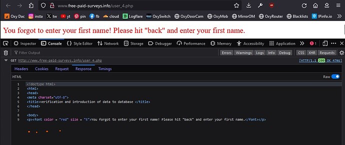

I had entered everything necessary on your form and when I clicked the button I saw error 500 in the browser console

I can’t tell you which DB your PHP code is trying to connect to
and it probably doesn’t succeed, that’s why you have error 500
in one of the posts above I gave you instructions for error 500
Did you do that ? and what did you see as an error after you enabled error reporting?
