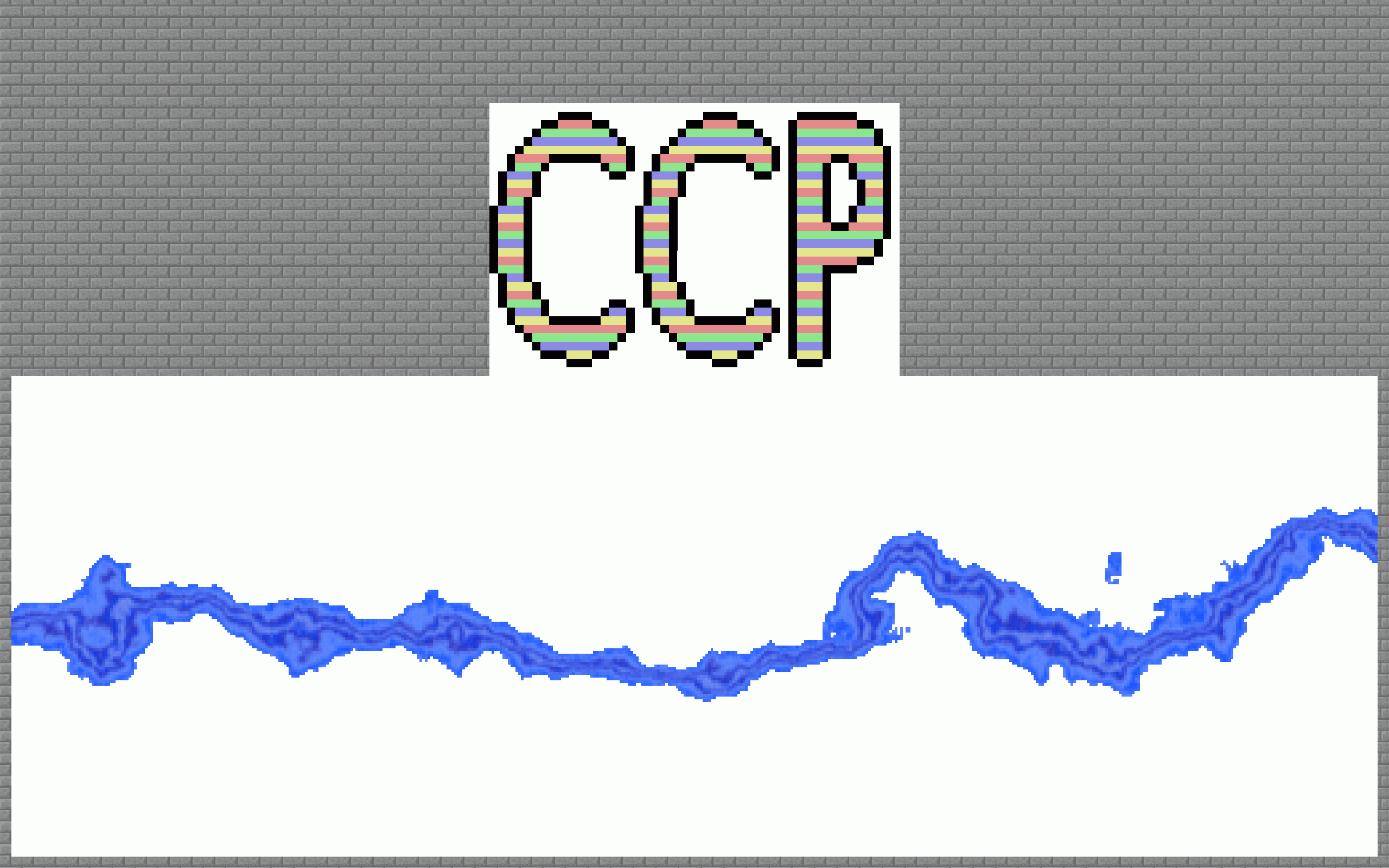

The site looks like this:

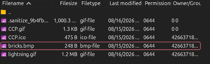

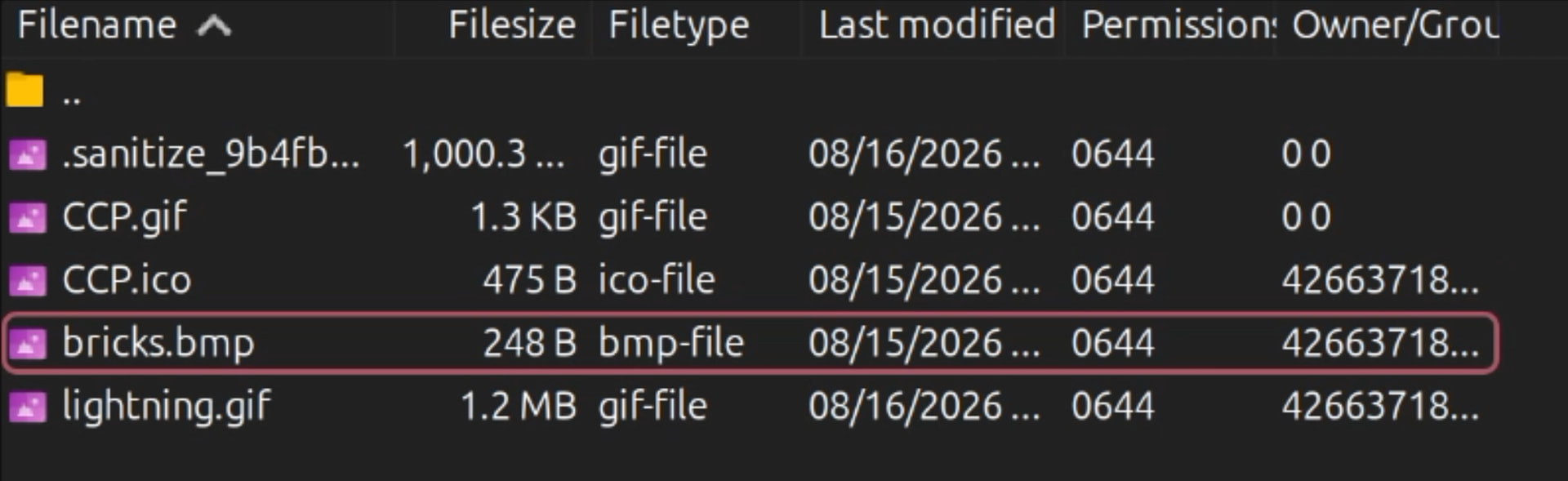

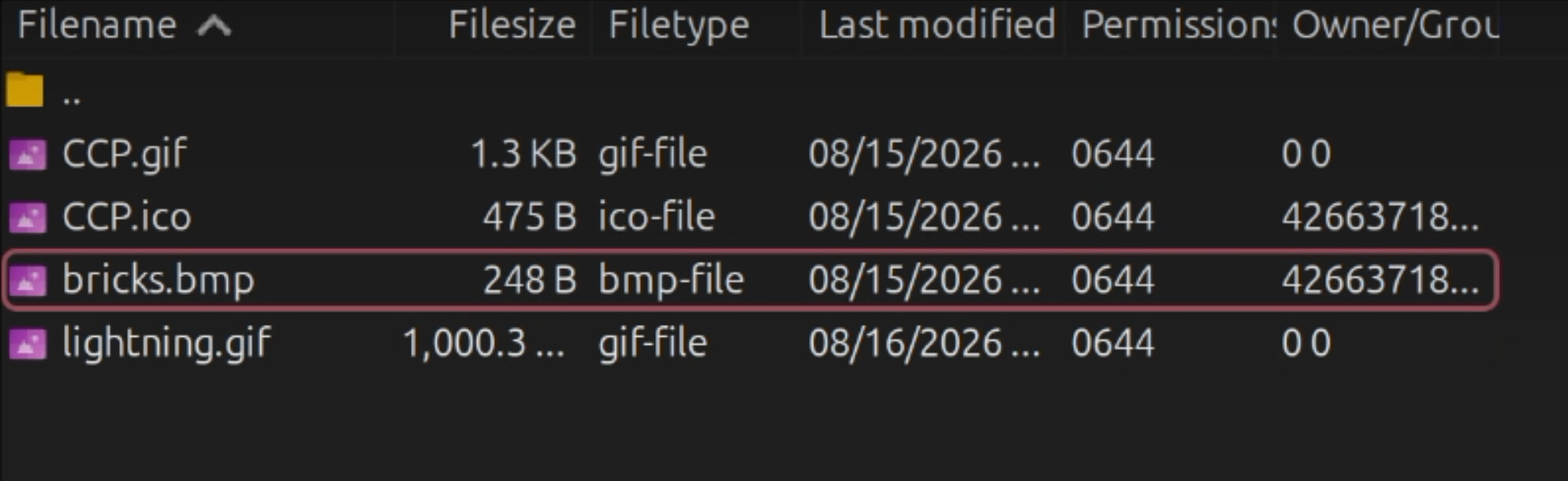

Downloading it again gives me the file with a white background. I can see that as soon as I upload it, a temporary “sanitize” file is created, then the file is replaced with the white background file with a shorter size.
