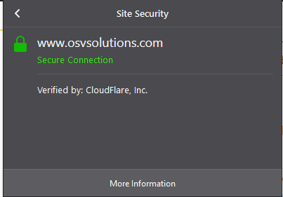

file_get_contents(): SSL operation failed with code 1. OpenSSL Error messages: error:14090086:SSL routines:SSL3_GET_SERVER_CERTIFICATE:certificate verify failed
Further debugging and researching lead me to here. Apparently, the ssl certificate verification is failing and not sure why. Because I have ssl enabled from CloudFlare and it shows that my web site is secured.
