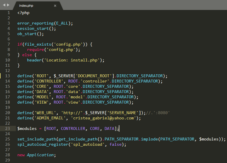

But looking at the documentation, I don’t see anywhere that you’re actually including the given class. You set the include path with a few additional and you set the autoload function to the default (why???). But nowhere do you actually require or include any files. So where should the Application class be loaded from?
So are you really sure that this is the exact code that’s working on your own computer? Because I honestly don’t understand how this could work.
The image below defines the exact paths to folders, the inclusion of files is done by the function set_include_path () after which they are loaded with spl_autoload_register () the “Application” class exists, but it exists in the “core” folder from where it was to be included in index.php with set_include_path ()
Yes, i’m really sure this is the exact code where i use in my computer and it work very good

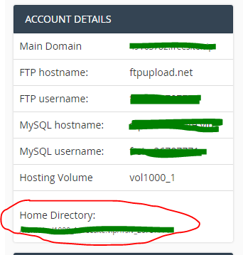

If what you mean is file path, please note that /htdocs/ is the root, not /
If is /htdocs/ or / is not working…
Maybe try set to home directory under VPanel with /htdocs ?

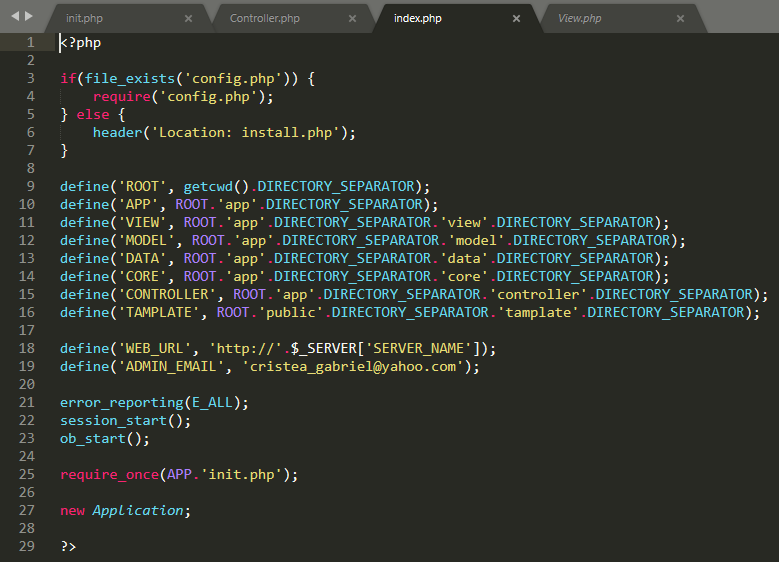

I resolved it I modify a part of structure and put important files require into init.php and i included it in index.php, now all works fine, oh, i changeed $_SERVER['DOCUMENT_ROOT'] with function getcwd() and it works ok
