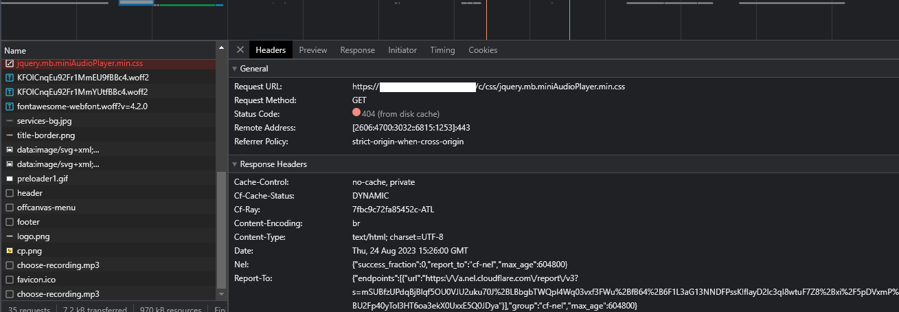

Added a screenshot to show the issue in development tools

Thank you! I attached the screenshot of the filename. I also updated the .htaccess to enable directory listing.
Ding ding ding! The name of file contains jQuery, not jquery.
Ah, here’s the problem. The Q in jquery is capitalized; this is why you get issues.
As mentioned before, Linux systems are case-sensitive, which is why this happens.
The “Redirected to InfinityFree 404 error page” article explains this in detail:
You’ll need to either update the file to use a lowercase q, or update your link to something like this:
<link rel="stylesheet" type="text/css" href="c/css/jQuery.mb.miniAudioPlayer.min.css" />
