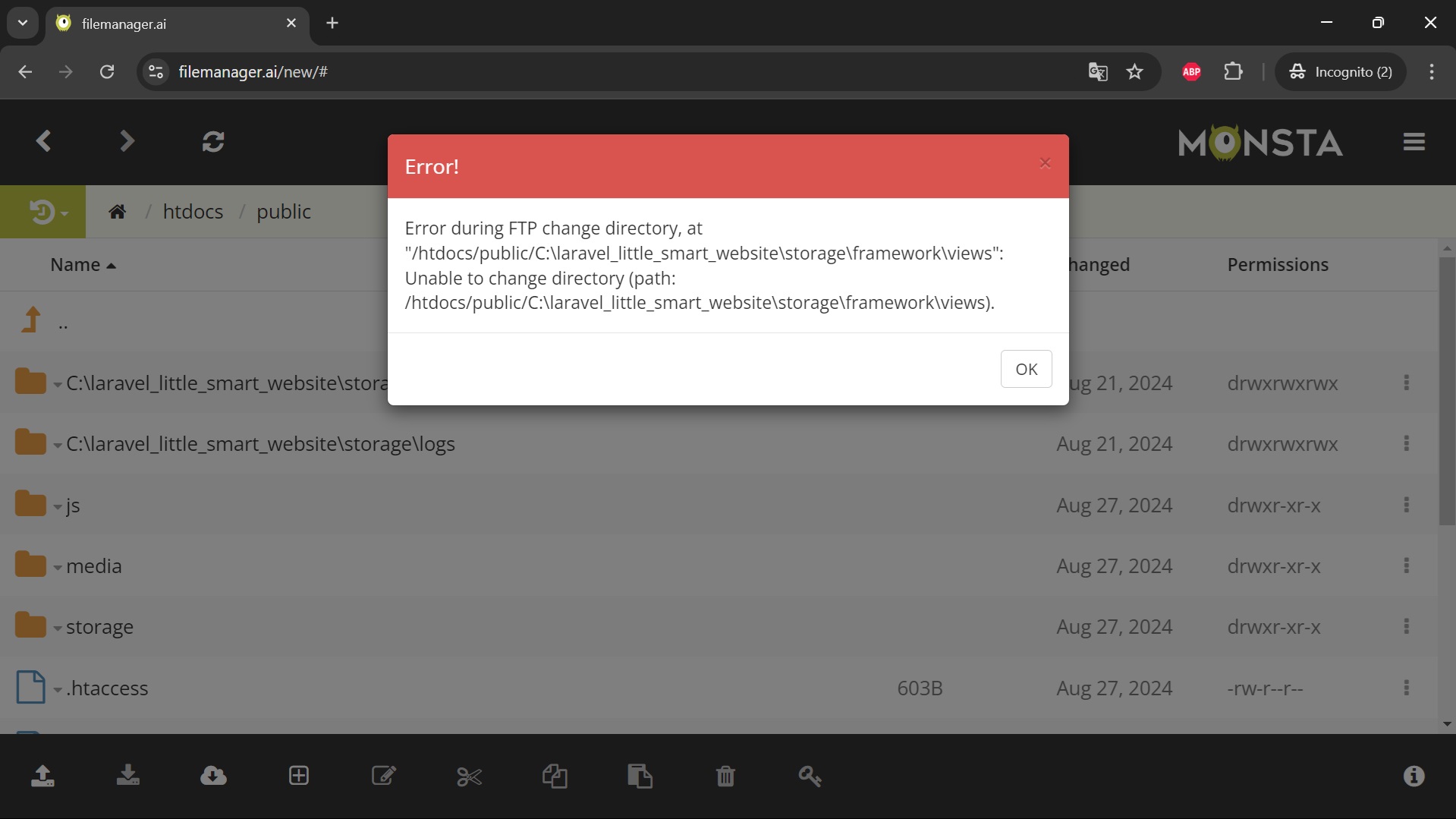

Error during FTP change directory
https://filemanager.ai
ftp username: if0_37135633
Unable to change directory
Could not retrieve directory listing
No such file or directory

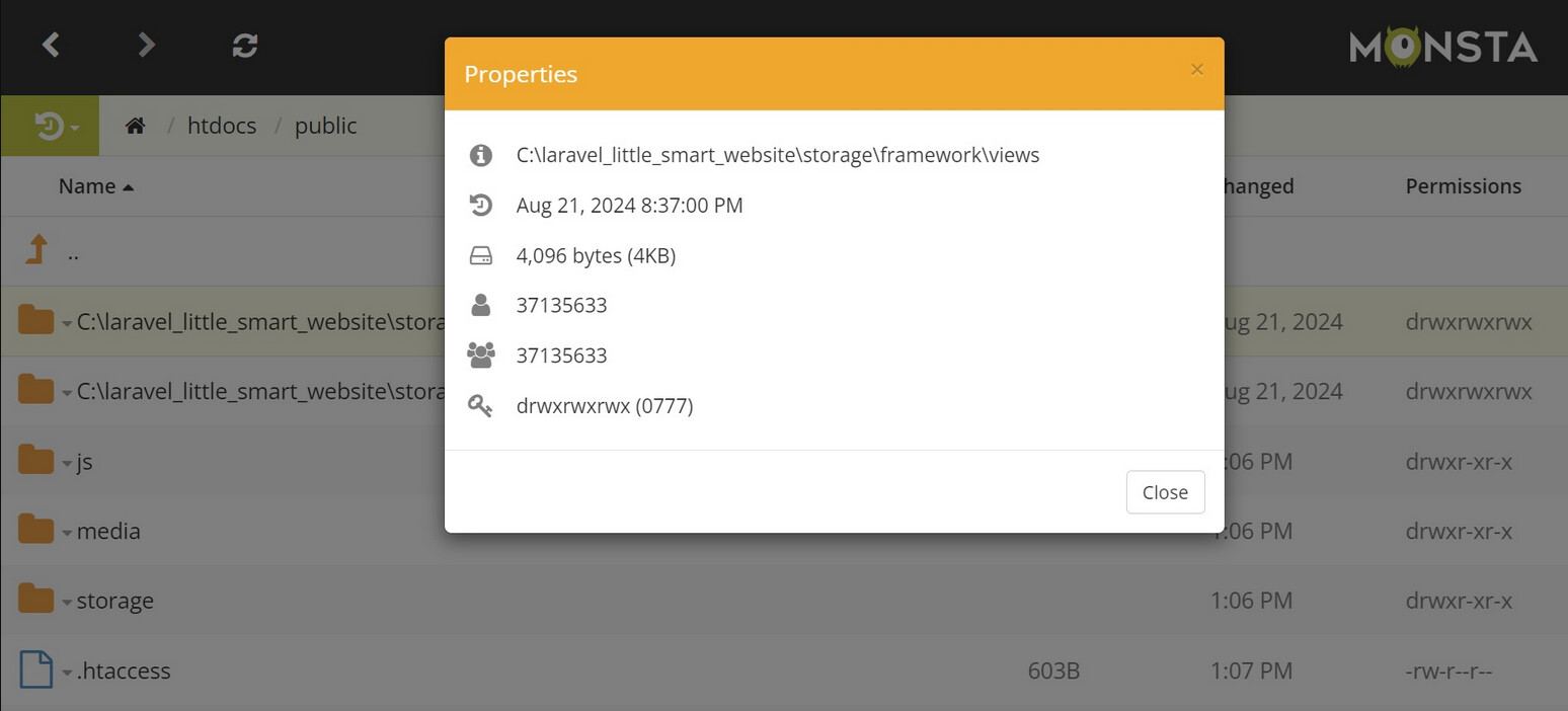

I am cleaning up my remote directory, but there are 2 particular folder(shown in screenshot) I am unable to do anything. Both folders have 0777 permission. I believe these folders the remains of last time when my laravel /bootstrap/cache was configured to my local machine rather than remote directory.(just a guess, not certain)
My concern is, those ghost folders, do they consume my inode usage? As I have no use for them, I would like to remove them if possible: (full path below for convenience)
htcdocs/public/C:\laravel_little_smart_website\storage\framework\views
htcdocs/public/C:\laravel_little_smart_website\storage\logs

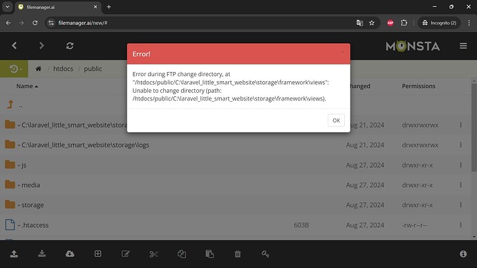

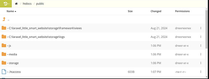

@LunarDerrick I hid the previous screenshots and replaced them
Never take a screenshot from the Monsta file manager so the address is visible
because anyone who sees/writes it can access your FTP
The problem is that the file path has a backslash in it, which is an invalid path character and then Monsta goes crazy.
