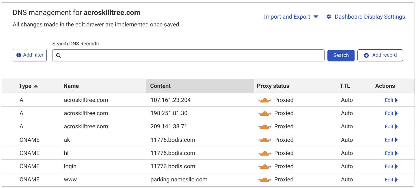

I just recently set up a free SSL with Cloudflare for my website. Cloudflare now says it protects my website and all SSL checks seem to be fine (with SSL-checker and dnssec-analyzer), but now the website is down with error 522?
I could see many posts in the forum about this error, but every time it was solved specifically, when some InfinityFree admin advised to remove a specific IP from their list or informed that some IP had been attacked… I wonder if someone can help me see what happens now with my case?
Als here my DNS records:
Thanks!
Adding a screenshot of the error message. I also notice that the IP mentioned at the bottom does not match with any of the DNS records on Cloudflare. Is that normal?

Remove these
It should be pointing to
If CloudFlare is running on full mode, you do not need this as well
On top of what @KangJL said to do, also do the below:
Create the following records:
A @ 185.27.134.143
A www 185.27.134.143

Remove the 4 CNAME records that you showed in your original screenshot, then try again.
Thanks!
That worked out :slight_smile:
