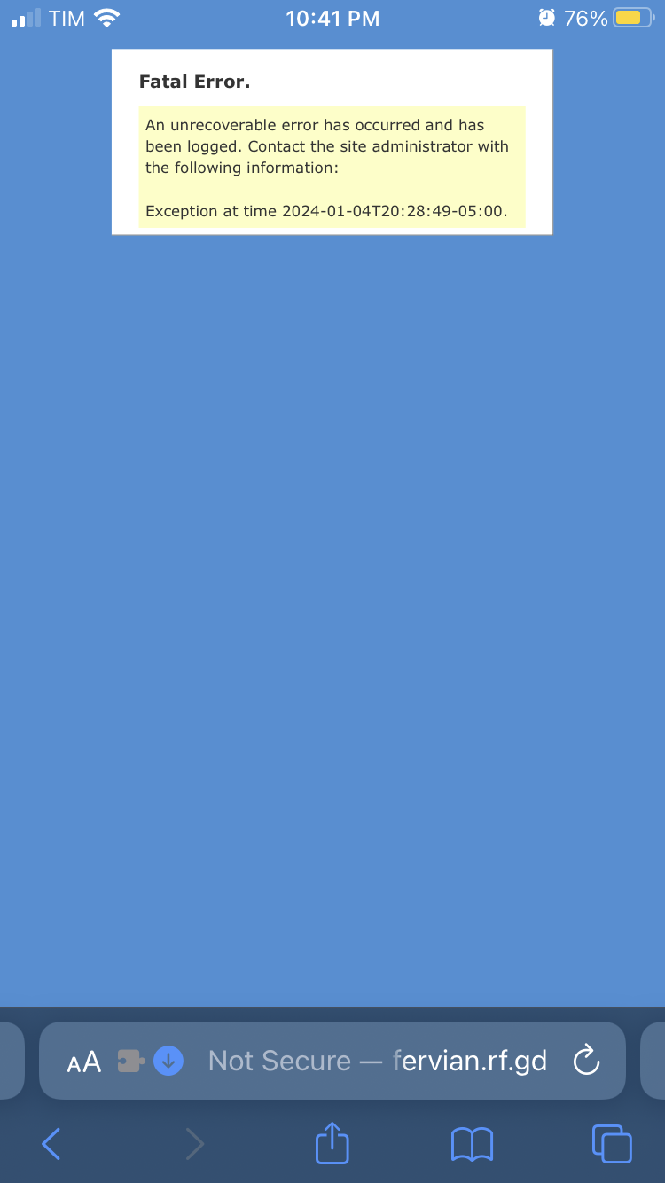

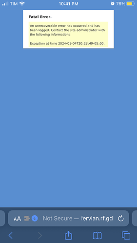

Fatal Error.
An unrecoverable error has occurred and has been logged. Contact the site administrator with the following information:
Exception at time 2024-01-04T20:28:49-05:00.
Hi, it’s me again ;(
So Elgg was updated and now I can install it, and after fixing the config PHP file I can run the installation, but with some problems.
My friend tried to create an account, appears that she managed to create the account but wasn’t being able to login, so I resolved to delete the created one, re-create it by myself and give her a temporary password until I have time to search how to fix this problem, then I discovered that the problem is bigger than I thought, when I try to delete the user I get an error, so I decided to create another user with other username just to not leave her waiting for too long and I got other error (the same one, but the user was created) now she can log in but I can’t delete, ban, disable or make any change to an existing user account.
I started to search about this and even considered reading all the database documentation to fix by myself. Then I realized that I forgot to do a essential thing: read the logs. But for my surprise InfinityFree doesn’t stores PHP logs, neither does Elgg, so I decided to ask for help here before reading all Elgg’s documentation, also by manually modifying the database I would not be able to let the users create their accounts from “Login”.
I know you probably cannot help with something that’s outside InfinityFree’s range, so let me know if it’s the case.
Thanks for any attention!

I think you will need the logs regardless of who you’re going to ask for help. Right now, all we know is that something is going wrong. Until we know what that “something” is, there is not much anyone can do.
