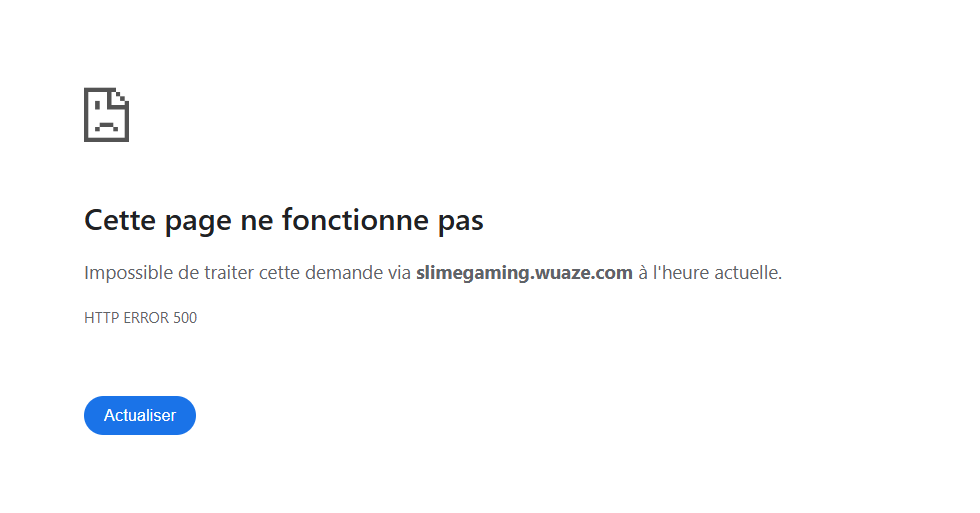

Error 500 if i install Kuked Klan in Softaculous
http://slimegaming.wuaze.com/
i install Kuked Klan for gaming and i have this error
Hi and welcome to the forum!
now i have this error :
Fatal error : Uncaught Error: Call to undefined function set_magic_quotes_runtime() in /home/vol17_2/infinityfree.com/if0_37600211/htdocs/globals.php:53 Stack trace: #0 /home/vol17_2/infinityfree.com/if0_37600211/htdocs/index.php(15): include() #1 {main} thrown in /home/vol17_2/infinityfree.com/if0_37600211/htdocs/globals.php on line 53
I presume this error comes from the removal of that function on PHP 7, whereas our hosting uses PHP 8.2. You’ll need to find software that’s updated enough for it to support PHP 8.2 or try to rewrite it so that it uses functions not removed in PHP 8.2. Also, read this:
there are solutions ?
I don’t know what software you installed. Your account is empty, and if I search for “kuked klan software”, then the only result I see is from your post here. And if I just search “kuked klan”, then I think you can guess what the results are all about.
But judging by the function that’s missing, it’s clear that this software hasn’t been updated in at least 10 years.
So the best recommendation I can give with the information I have is to look for different software to use to build your website, preferably something that’s still actively being maintained and updated.
Maybe I can tell you more if I know the software you were trying to setup.
no i make a mistake the name of the software is nuked klan
Thanks, that’s software I can find.
But it seems to be abandoned. The last release is from January 2016, and the GitHub project was archived over a year ago.
So it seems that this project is pretty dead and won’t ever be updated to work with any remotely modern PHP version.
Also, it seems to be the final project in Softaculous in the gaming category, which suggests to me that there might not be an alternative to this software.
I don’t know what this software is supposed to do, but maybe you can approximate the functionality using more generic software.
