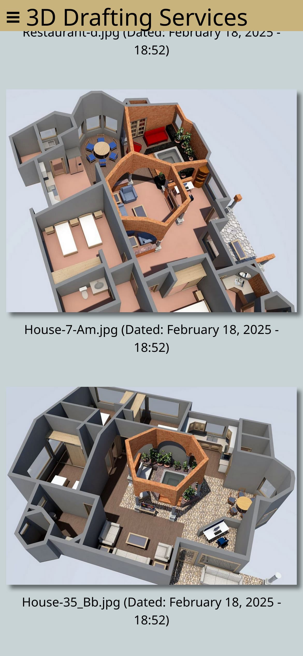

I removed cache. I also tried another browser. The 404 error shows at the end of the page. Here’s a screenshot.
This is what your website looks like from my browser.
