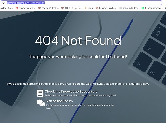

Error 404 in CodeIgniter code
https://pacmanapicaparrella.wuaze.com/test-db doesnt work, without test-db works fine.
Tried googleing, chatgpt, copilot…nothing works…

Welcome to the community.
I’m not seeing any 404 error at the provided URL:
Also, if you are making requests to the hosted API from your local machine, you will encounter a CORS error. This behavior is intentional and cannot be removed:
Now i have changed .htaccess and seems to work, dont know exactly what i die:
