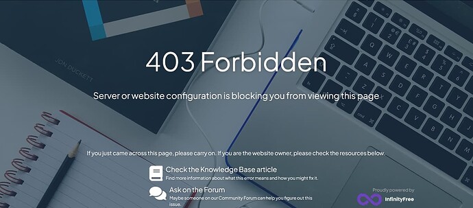

Error 403 forbidden
https://catholicagora.lol
Please read
I went through that already and it didn’t seem to help me solve my problem.
So what did you do?
your domain is redirecting to .cf !!
I had two domains on my IF account so I deleted the .cf domain and kept .lol. So now the url for some reason is redirecting to the previous domain .cf. Help?
