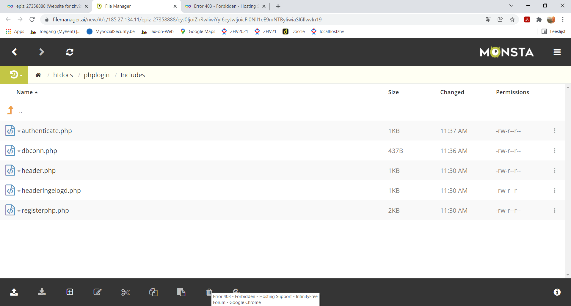

What am I missing here??? All the files are where they are supposed to be
Are you sure you have the correct htdocs folder? Please screenshot the entire homepage of the client area, and make sure the “Account Info” and “Account Domains” sections are viewable in the screenshot.
Thanks
serverview is on the right
Root cause likely found
Rename “Includes” directory to other name
