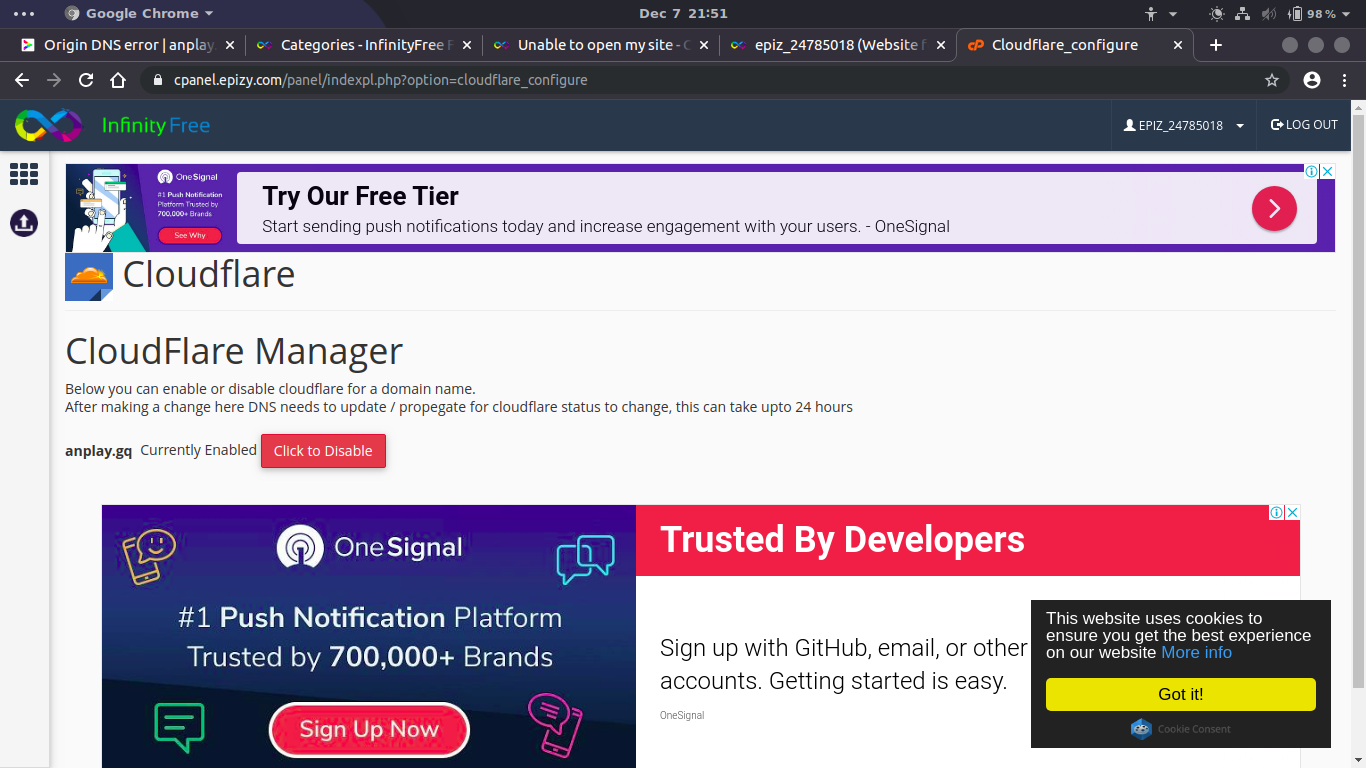

This Cloudflare Option I tried
Showing This
Please Kindly Fix It As Soon As Possible :blush:
