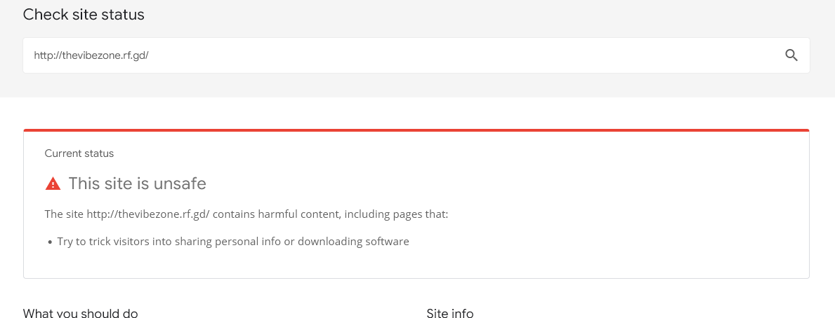

Oh lol anyways im making my own so i dont really need help with that XD what is bugging me is the email verification for signing up to my website it has nothing to with the forum yet once i get the verification method fixed i can then implement it for ranks and such on the forums easily
If you take a look here this is all im really working on right now http://thevibezone.rf.gd/login.php

No need, I see it in your code
btw. Google Transparency Report
after http://thevibezone.rf.gd/register.php leads here
and there it is already visible that your code has crashed (E500)
also
