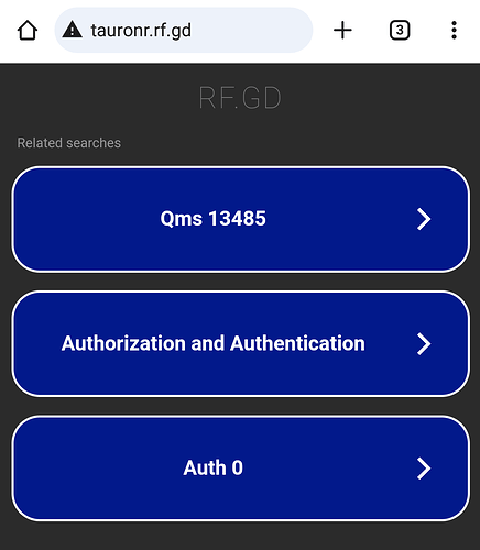

The site shows up as a typical “domain for sale” placeholder.

Also, if my ISP had the domain blocked, would I not be seeing some generic “website does not exist” page from my browser rather than the domain parking page I see at the moment:

Parking page is due to DNS propagation:
ISP’s have an unfortunate habit of blocking free hosting domains from time to time, mine do it regularly.
To get round this, I would recomend finding a free domain like pp.ua (see below) and add that instead.
Thats true, that parking page does look like its just that the domain hasn’t propogated. So if you wait and see what happens after the 72 hours (since you set up the domain). Its only 3 days, so it’ll pass before you know it :slight_smile:
Btw, this is what I meant when I said “website does not exist” page:
When my ISP block a domain, I get a blocked domain page. different ISP’s show different things
Since I had abandoned my website resurrection project years ago these three days won’t drive me crazy, lol :sweat_smile:
True that. And since this isn’t what I’m seeing it is most likely that DNS propagation is still ongoing, right.
