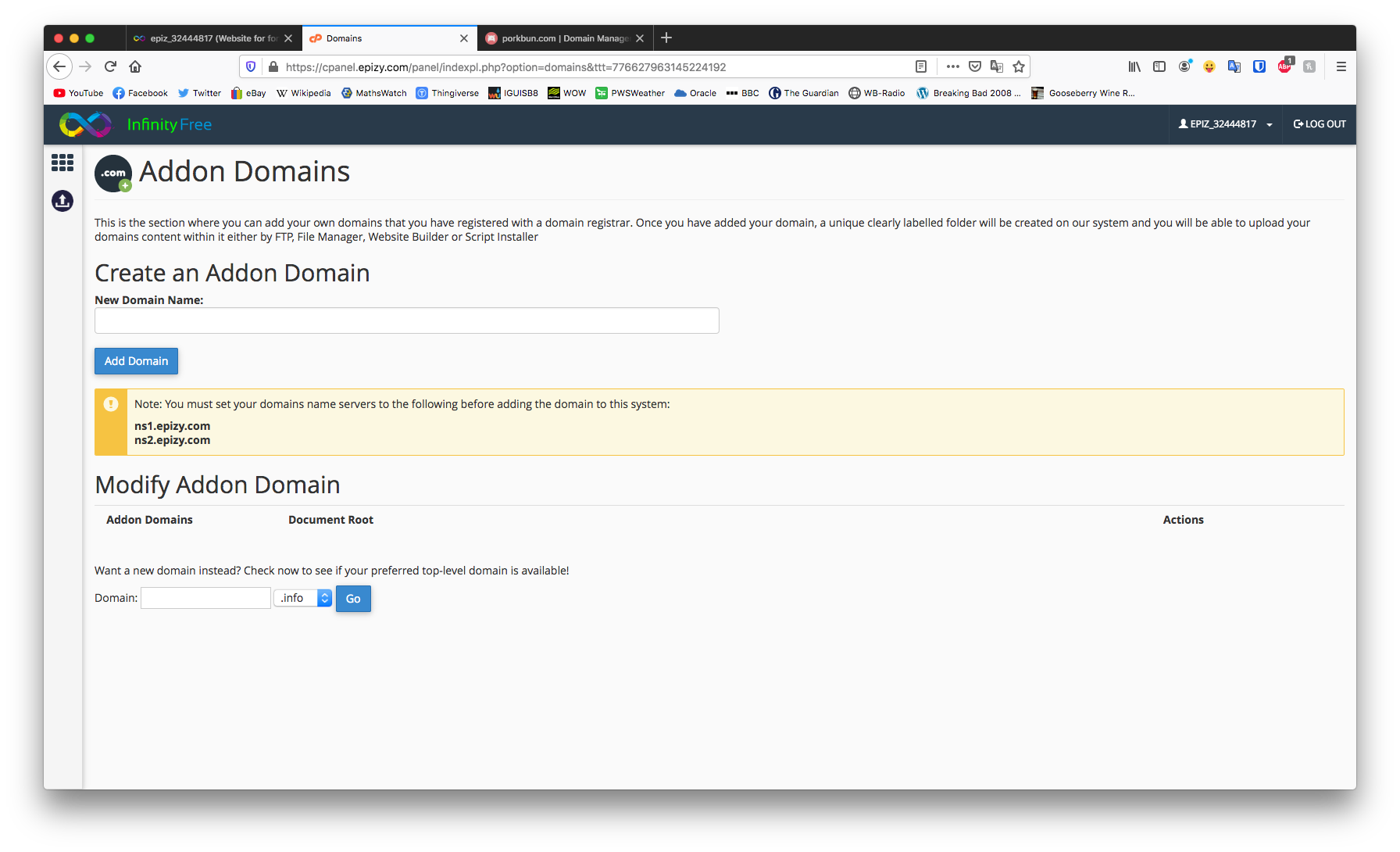

Not an error message, but domain is not connected, and will not load on any other device except computer. When I try and add it to the ‘Addon Domains’ in the cPanel, it tells me that ‘domain is already assigned and in use.2’ yet it is not working on any device except my computer, nor is it working for my friends (and downdetector says it is down also.)

It will not let me remove anything. It is removed in cPanel but main website page still thinks it is attatched.
It still thinks the domain is attached and it isnt.

Yes sorry I meant that first. Its not attached to anything in cPanel and is incredibly glitched, an admin is neccesarry. I was logged into the correct one, worry not, just a typo on my forms listing.
I did not mean to say the one I meant in my form listing, it was a typo. What I am saying is the control panel in the image is saying forwarduk.xyz is attached and its not saying that it is in the ‘Addon domains’ section of cPanel (Control Panel) and when I try and attach it, as it is not attached to any existing site, it tells me ‘forwarduk.xyz is already assigned and in use.2’ and it is not assigned to anything, on the website’s cPanel. But the page featured in the image (accounts page) says it’s still attached.

it is there in parked domains but not the addon domains, and it is not reachable on any other device than my computer. There is a serious glitch. I am parking it with porkbun until an admin removes it from any existing account so i can freshly start again without any glitch.

In summary, there are two databases that contain the list of your domain names. The lists of domains should be identical in both databases, but very rarely an error happens that causes the databases to go out of sync.
The Addon Domains list in the control panel pulls from one database (in which the domain seems to be gone), and the client area and availability checker pull data from the other database (in which the domain seems to be present).
As far as I know, there is no way to fix this yourself. So I’ll send a request to iFastNet to get the domain removed properly so you can add it to your desired account. You should be able to add it within an hour or so.
