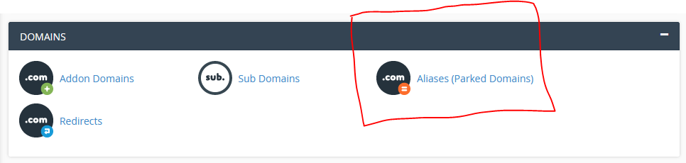

add the domain as a parked domain not an addon domain and see if it works

ok thanks now I try but before putting it as a parked domain I have to go and change the nameservers in my domain by putting these (ns1.byetorg ns2.byetorg ns3.byetorg ns4.byetorg ns5.byetorg) or do I leave these that I had already put previously in the control panel of my register? (ns1.epizycomvns2.epizycom).
and then can you explain better that it changes from the “addon domains” to "aliases (parked domains) setting
thank you so much for your help
in the name servers the first points of the “org” are missing because in the message he did not let me put them because he took them as a link
Either set works. If you are using ns1.epizy.com and ns2.epizy.com, thats OK, don’t touch it.
Each Addon domains has its own folder in the filemanager.
When you add a “Parked Domain”, it will share the same files as anouther domain name
