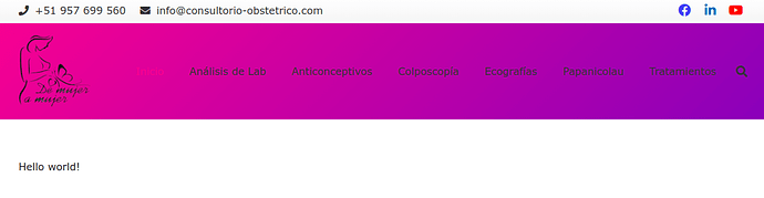

admin… nope, i didnt deleted anything…
the username of consultorio-obstetrico.com is: epiz_26387428
wordpress is there and its working…
