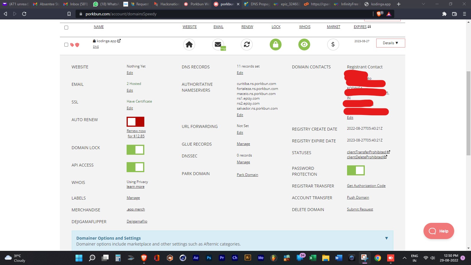

This is the issue:
As a rule of thumb: NEVER mix different sets of nameservers. Choose one party to provide the DNS hosting for your domain and use only their nameservers.
Even if you have a different web hosting provider and email hosting provider, you should always only use one DNS provider. Just adding the nameservers of all the providers to your domain doesn’t work.
You can use our nameservers and connect PorkBun’s email hosting through our panel or use PorkBun’s nameservers and point it to our web hosting.
If you need help setting that up, please let us known which nameservers you would prefer to use so we can provide specific information.
Thank u so much for the reply will this changes fix the problem ???
Yep, It is connecting now!

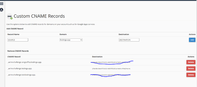

However, you are forcing HTTPS, but you don’t have an SSL certificate. See the guide below to learn how to get one.

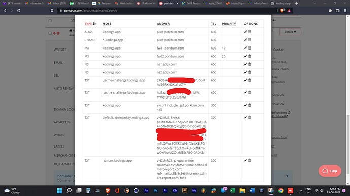

I have this from Porkbun
Well, you did not install it in the VPanel
I try to upload the key but im getting this error
You need to do this then
Ok thank u I am trying this so how many hours or day it will take ???
It depends. Just wait

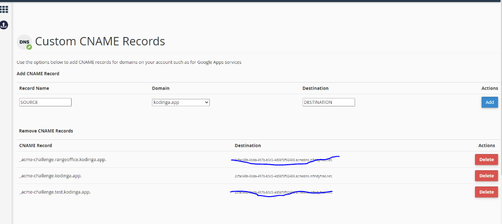

Take note each subdomain will also requires its own SSL cert
Ok thank u let see
Seems good
You can start to apply for SSL for other subdomains
OK i applied for other sub domain too

Hello there is a problem with my mail i am not receiving any email please help
Did you setup MX record in the VPanel?
Yes i contact to Porkbun team they give me this instruction but i dont know where i have to use so i put those two MX record in Vpanel
