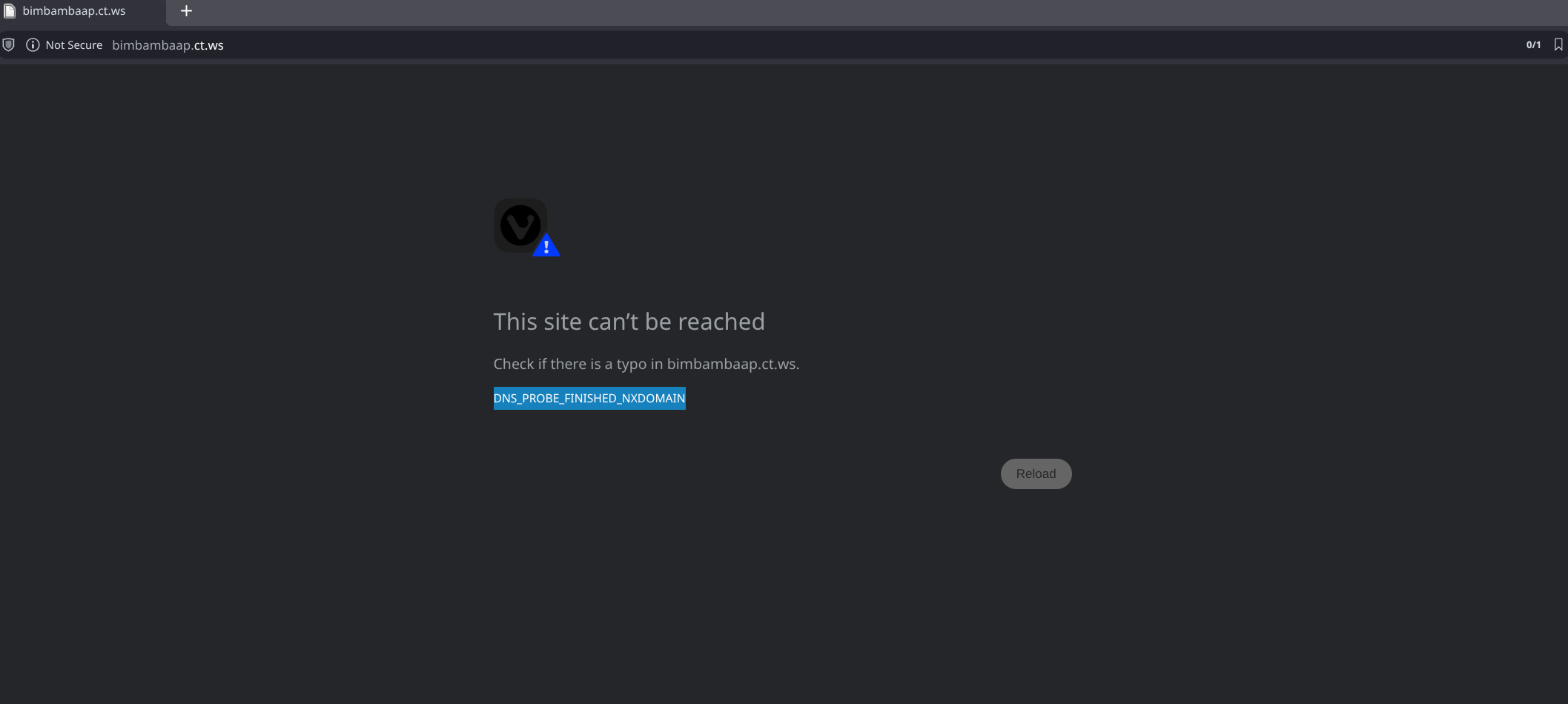

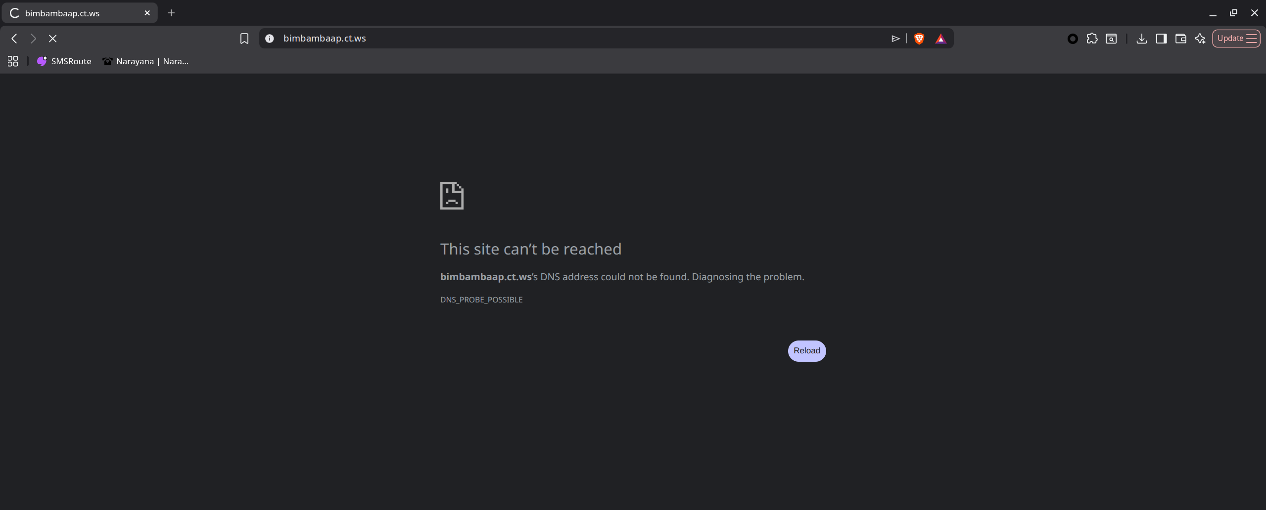

I understand, but you’re too global on DNS_PROBE_POSSIBLE. This is not a final error, meaning it can turn into something else, it’s just “still checking”. Here’s the difference between Vivaldi browser and Brave. Like I said, the errors from the other topic could be connected, but I guess this proves it
