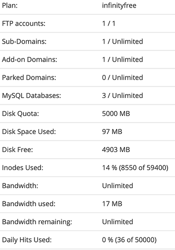

pls take a look at the screenshot, the inode limit is not reached
that screen on the dashboard is only updated I think once an hour (maybe less often) so if you’ve done a lot of uploads, its possible you could have hit it before the dash updated
Its been several days and the dashboard did not update.
ok probably not that then.

I suspect the client area counters may be wrong, so I manually scanned the file listing of your account. What I found is that you’re using roughly 500 MB of disk space, but also 46,000 files alone (not counting directories - which also use up inodes). So I think you’re having these issues because you’ve reached the inode limits.
I will look into getting the control panel counters fixed. But regardless, if you want to upload more files, you’ll need to reduce your inode usage.
