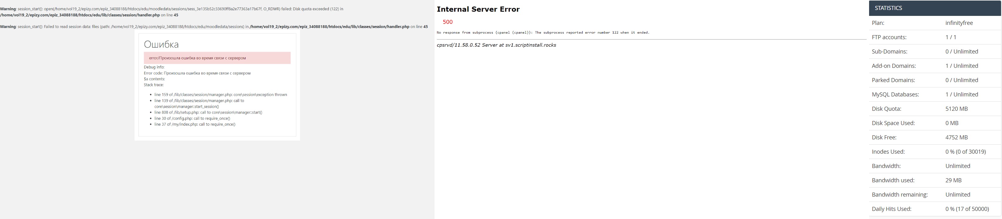

hello, I have the following problem. I put LMS MOODLE on hosting and was developing my course. Today, when logging into the administrator account, I get the following error (1 screen)
Then I tried to go in and look at the Moodle settings in the control panel and there it also gives an error (2 screen)

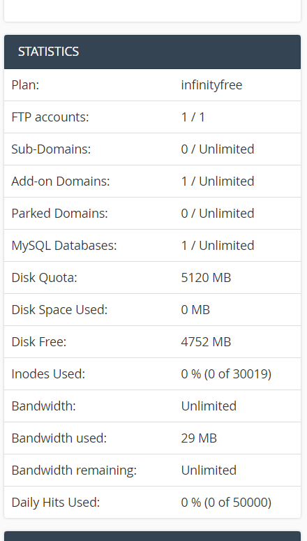

After studying the errors, most say that disk space has run out, disk quota exceeded, although this is not the case (3 screen)
Can you tell me what the problem is ?
the side panel takes 24h to update
Hmmm…is the disk on the server running out of space?
no, it didn’t take up much space here is a screenshot, they wrote with a comment above that the counter works 1 time in 24 hours, I will check
Thaks for help, I will check during the day, nothing has changed yet
You can try with another hosting account to rule out physical server running out of storage
A “quota” error means that the limit is hit for the account, not for the server. If the server was full, you’d see an error like “No space left on device”.

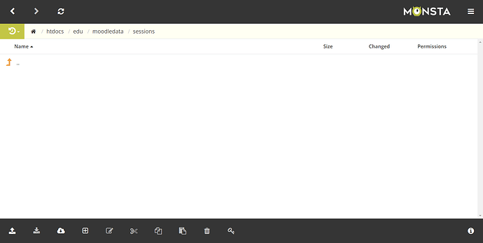

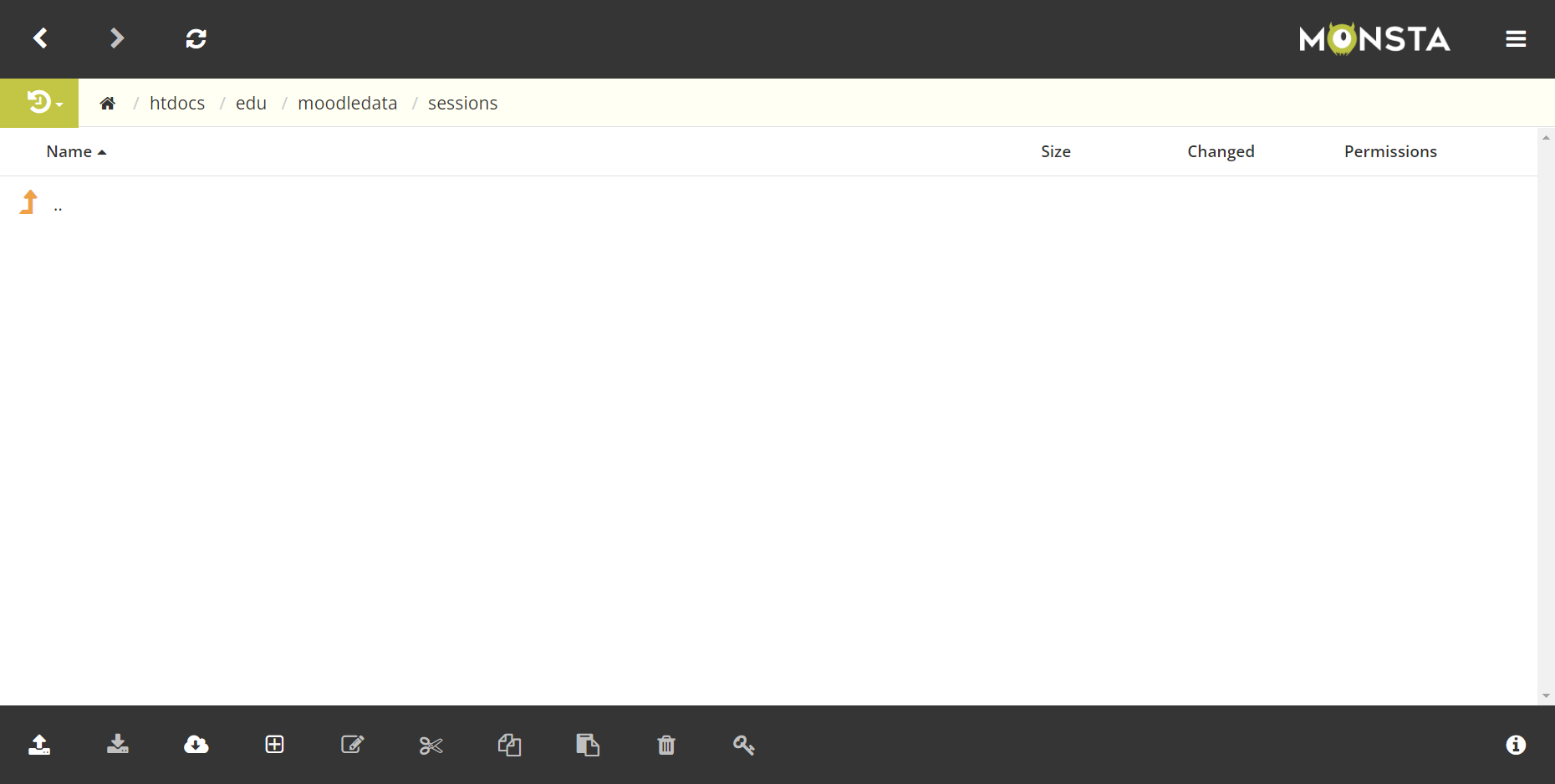

I suppose you could try to clear the session storage by hand.
Looking at the error message, it appears that Moodle stores sessions in the directory htdocs/edu/moodledata/sessions/ in your account. If you go into that directory and delete everything there, it should free up some inodes with minimal impact to visitors.
Hello, thanks for the advice, I did everything as you said, but nothing has changed, the error remains
