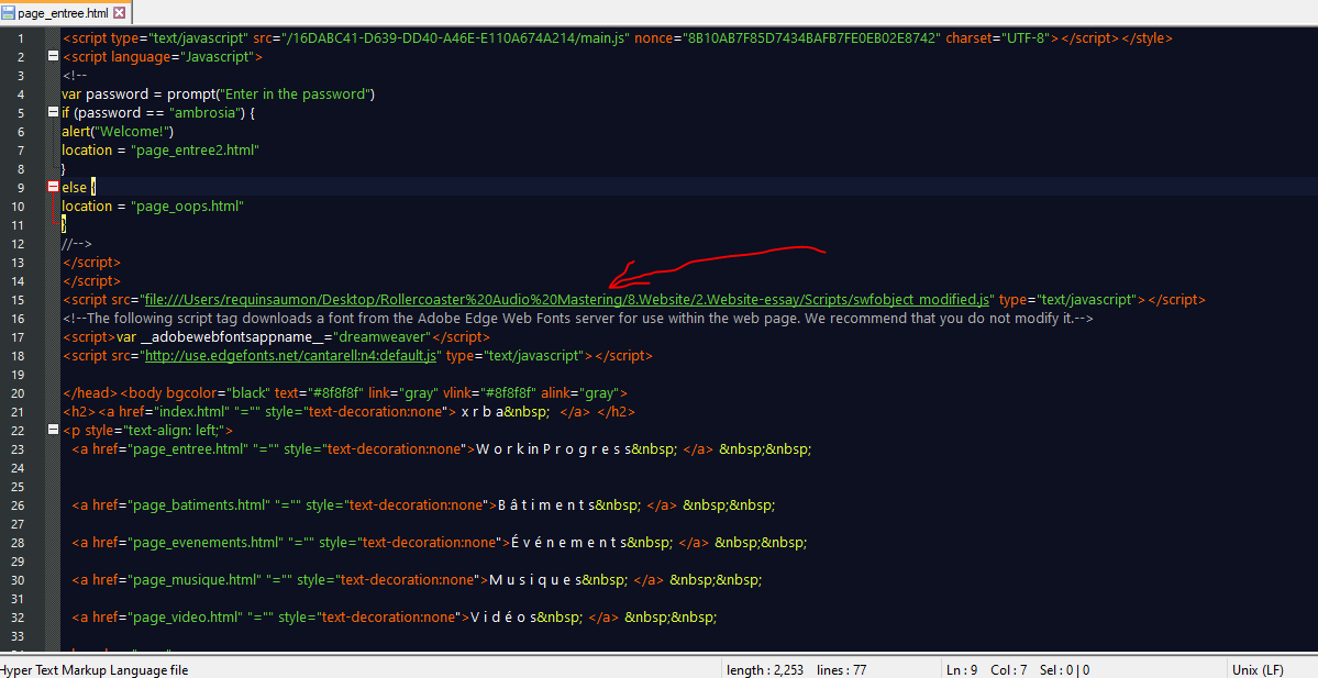

this page is incomplete - missing the main html elements
like <!DOCTYPE html><html><head><meta charset="utf-8">
and some elements are closed and opened in the wrong order.
You are calling here JS script but at the local address in your PC instead of on the server
btw. don’t use flash - Adobe flash end in 2020.

put this script in body
remove this "="" wherever it is (in all pages)

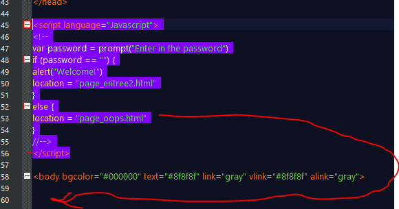

Your page password is Null! Note you’ve to disable Javascript codes with // or /* and */. Other wise JS executer will look at <!-- and --> and will say " I do not know what do they mean" and will execute codes well.
Try this one instead :
<script language="Javascript">
var password = prompt("Enter in the password")
if (password == "") {
alert("Welcome!")
location = "page_entree2.html"
else {
location = "page_oops.html"
</script>
