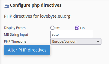

From your account dashboard click on cpanel then in the software section click on alter php config
From there you can click alter php config and then enable display errors
Thanks, I hadn’t seen it and I’ve already checked that the error reporting works, but the environment where I have the connection to my FTP is SVG and I’m having trouble getting it to show the errors, if there are any, since I get the impression that when the connection fails, which isn’t always, it does so silently.
