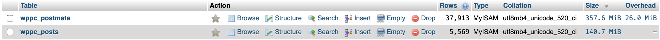

I suspect this happens because my website is on a free plan and phpMyAdmin may have a size limit for exports. I can export smaller tables (around 30–40 MB), but I have two large tables more than 10 MB — about 140 MB and 357 MB—and I can’t download them in anyway.

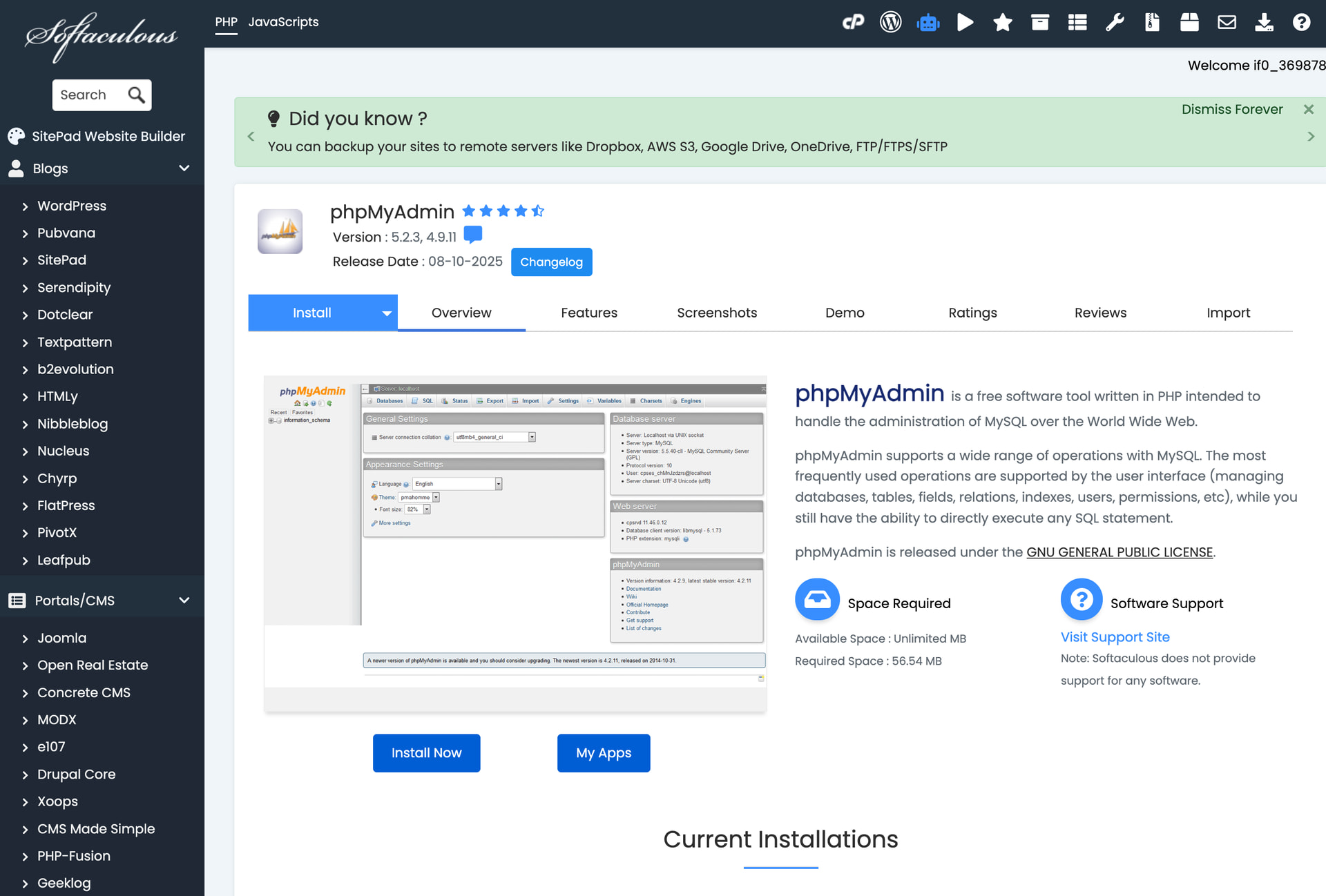

mywebsite is just a placeholder for my real website domain. I installed phpMyAdmin through InfinityFree’s cPanel.
mywebsite is just a placeholder for my real website domain. I installed phpMyAdmin through InfinityFree’s cPanel. I don’t know is it Client Area or self hosted actually.
This means that you are self hosting a phpMyAdmin instance which is not recommended or supported. Please try using the phpMyAdmin provided in the Client Area instead.

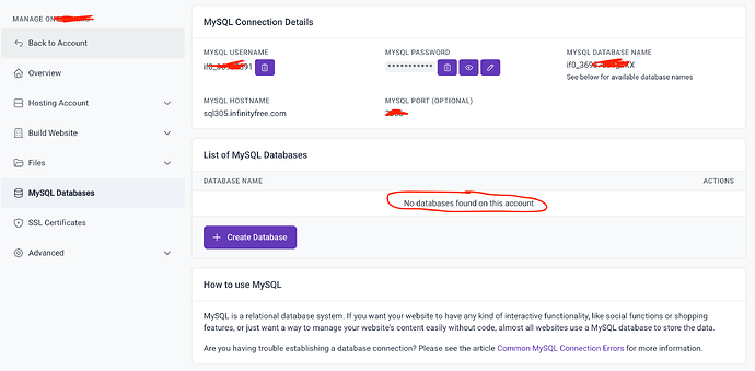

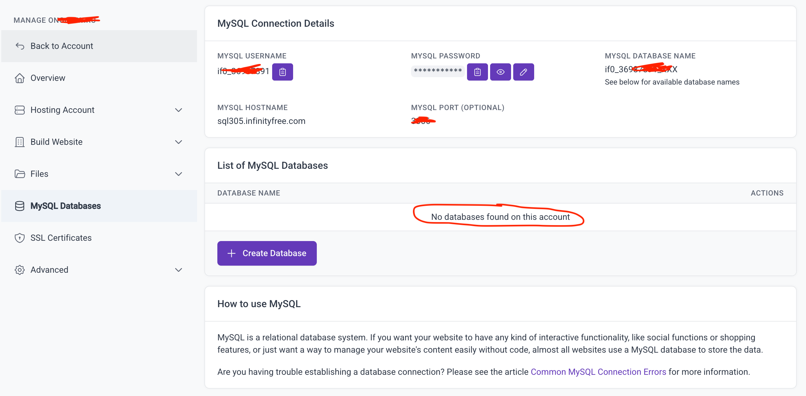

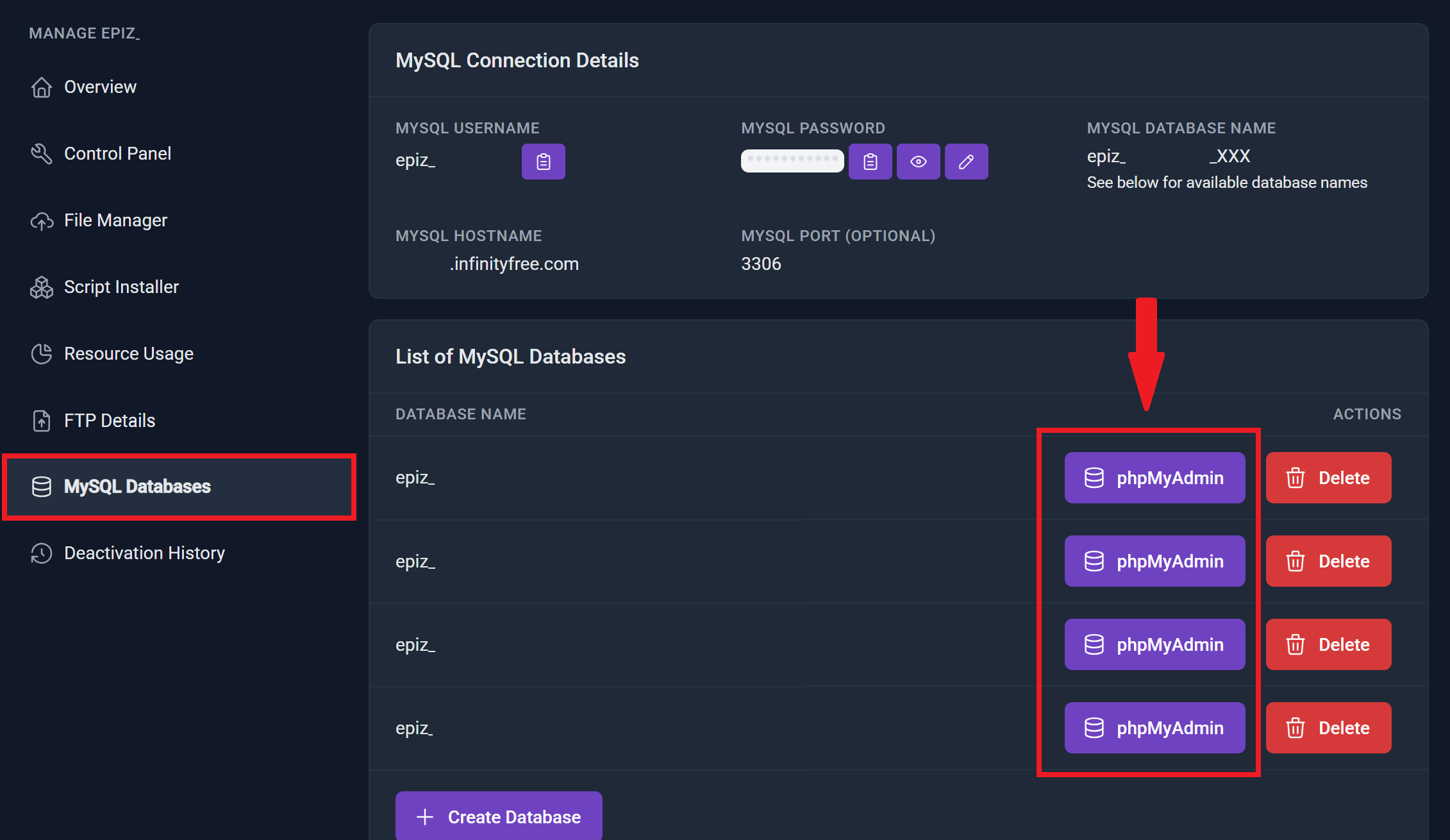

Hmm, I have none in MySQL Database section:
while I have two:
It’s a common bug, when you install WordPress through Softaculous the database is not synced to your account; the database is still there and simply create a database with that name will fix the issue.

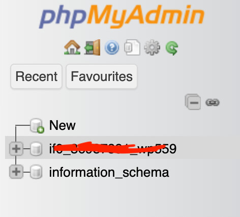

Yes, it works, now I can see my database:

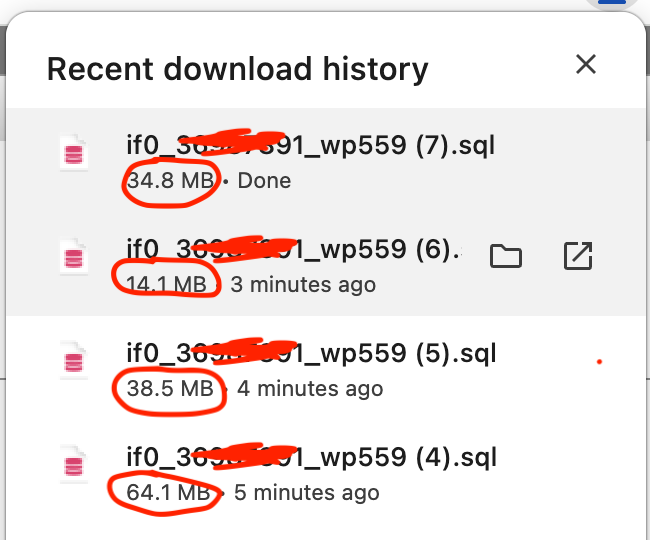

Now, when I click the phpMyAdmin button, I successfully access my database. But when I select a large table (140 MB) and click Export, the downloaded file is smaller than the original table. Also, every time I download it, the downloaded file has a different size.
Looks like Client Area version of the phpMyAdmin has the same issue - stop downloading after about 10-20 sec.
I tried using different browsers, but I still get the same error. This clearly looks like a hosting issue/limitation.
Why can’t I download even a single large table in its entirety? Any help please!

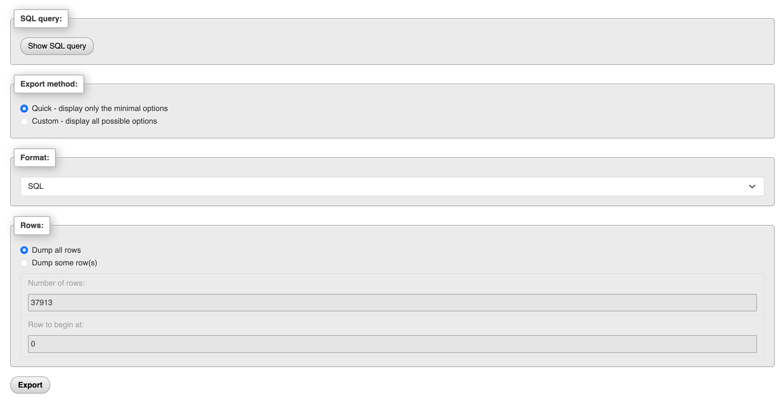

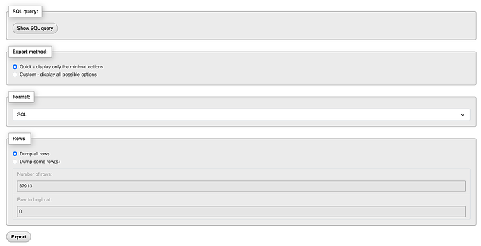

What are your export settings in PMA?
I’m using Quick export (Quick - display only the minimal options) with SQL format.

I tried many times to download the large tables (140 MB and 350 MB) using different devices and networks, but the result was always the same: the downloaded file contained only a small part of the table.

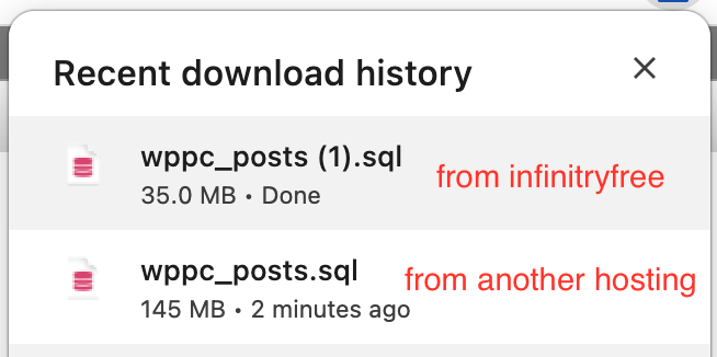

So what I did with one of the large tables was download it in parts. It was a nightmare because there were many parts, but in the end I managed to download them. After that, I uploaded those parts to another hosting and combined them back into a single table.
Now, on that other hosting, I can download the entire table in full without any problems (see the screenshot). The same original table downloads partially on InfinityFree, but it downloads completely on the other hosting.
Because of this, the only conclusion I can draw is that there’s a problem with the InfinityFree hosting or my account specifically, not with my connection or anything else.
And after downloading a large table many times, I still don’t understand what the exact limitation is—whether it’s based on volume (size) or on time. The download time and the downloaded size for the same table are always different. I didn’t notice any repeating or consistent numbers for either time or volume, so it’s still unclear to me what exactly limits the download.
Right, that’s clearly an issue. An export being a different size every time is very strange.
I just spent two hours to figure out what caused this, but I was able to find it: the server has a max_statement_time setting, which kills all queries that take more than 4 seconds to run. Export queries from phpMyAdmin are hitting that limit, and phpMyAdmin silently swallows the error and skips the chunk of the table. Since the exact query time varies between runs, that explains the incomplete backups of varying size.
