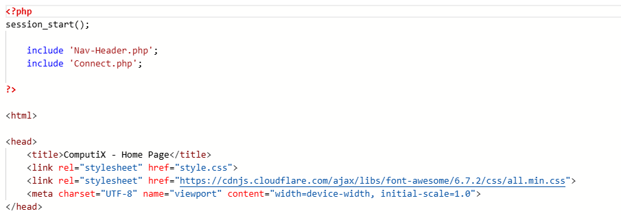

When I visit my website I only see the logo image displaying but all the other images aren’t even loading, with the same referencing as the logo. The css styling also doesn’t display what should I do?

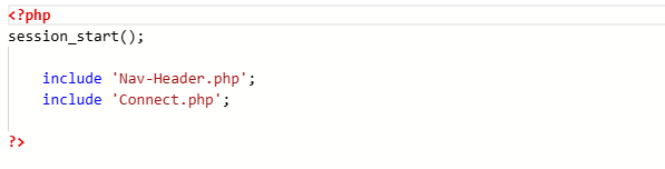

The main issue appears to be this line at the top of the file:
<php session_start(); ?>
The question mark in the PHP opening tag is missing (it should be <?php instead of <php). As far as I can tell, this extra tag outside the HTML document is thoroughly confusing the HTML parser of my browser, making a big mess of the content.
I suggest changing this first and see if it helps.
Additionally, when I check the Console in my browser, it tells me the page responded with a 500 Internal Server Error. This usually means the PHP code crashed. That can also result in an incomplete page being generated.
thanks ill look into it
which file exactly cause this is the index
when I inspect my page on chrome i see what you’re talking about but in my actual code this isn’t there.
fixed thanks
