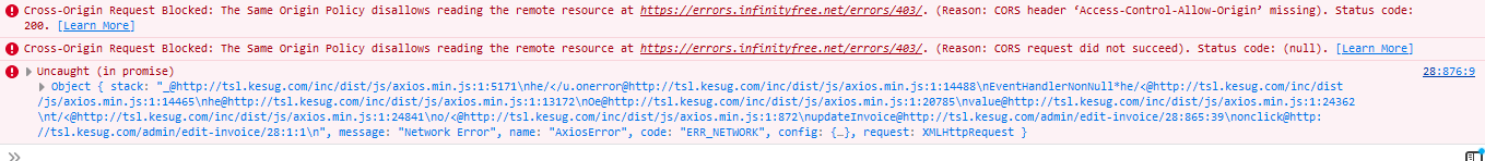

Cross-Origin Request Blocked: The Same Origin Policy disallows reading the remote resource at h
How to re-solve it. Please note api link keep in same domain. Everything is ok but when using put function with axios.put api link then above error is shown. kindly assist please
The issue at hand isn’t that your website is getting CORS errors, it’s that your website is trying to access our 403 Forbidden page in the first place.
Please check which URLs are being accessed on your website that redirect to the 403 page, and try to figure out (and fix) why that happens. This guide may have some useful pointers:
If you need help figuring this out, please clearly state which URLs are triggering the 403 response.
above errors found in chrome when click on an axios put link for edit database records. Kindly assist, how to resolve this errors
