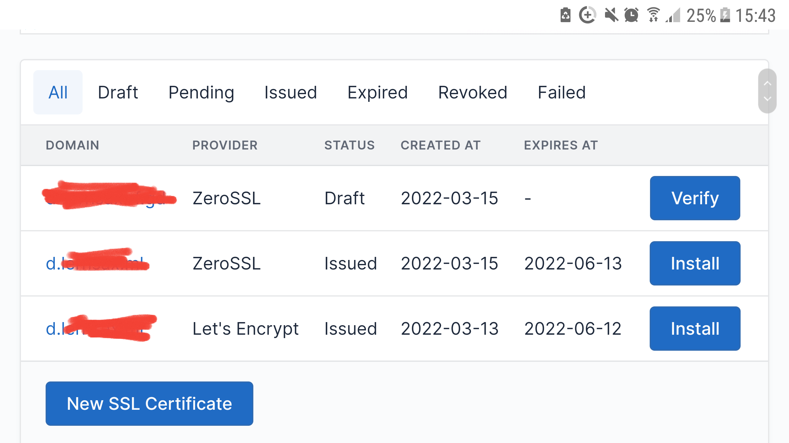

The certificate uploaded is NOT for the domain name d.“mydomain.com ” ( was seen) .
My privat key and my certificst from Log in to your account - InfinityFree doesnt work
What is your provider? Try from another brwoser.
I used 2 diferent certifikates
Can you send pic? Not the info page. Try from another browser anyway.
Not work wirh other browsers
Send the pic of this page for you:
Hide the email address!
Unable to see the image, try re-uploading?
please show the domain. I hid jsut for mine.

But i createt it form the right domain

Are you sure about that? I just tried to install the ZeroSSL certificate for the d.****.ml domain, and it worked without any problems.
If you’re trying to upload it to your base domain ****.ml, or your ****.rf.gd domain, that’s not going to work, because the domain in the certificate must match the domain for which you’re uploading it.
