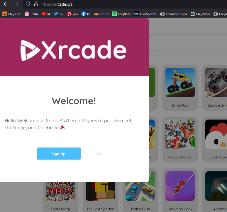

I see it like this

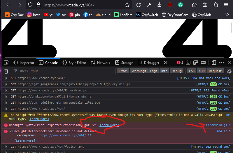

Besides that, you have a problem with this custom error page of yours
Either that file does not exist (ErrorMain.js) or you gave it the wrong extension, so instead of .js it should be .html ?

I am aware that ErrorMain.js is no longer there (it is an old 404 page I need to update it), thanks though, I will try what you suggested
