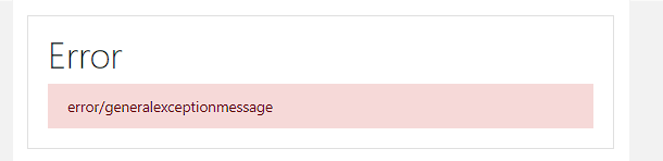

i tried but after moving moodledata folder in htdocs and changed path in cofing.php (/home/vol6_4/epizy.com/epiz_33844728/htdocs/moodledata’) its showing new error on website.
is there any other way to get access folder outside of htdocs folder or run moodle on free hosting?
Hi rajguota6969,
This simply means moodle has thrown an Exception somewhere in their code, you might want to check with the error log if you have enabled this in your php settings.
