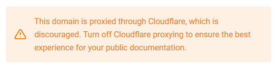

I’m trying to use GitBook with InfinityFree but with no luck.
This domain is proxied through Cloudflare, which is discouraged. Turn off Cloudflare proxying to ensure the best experience for your public documentation.

Cloudflare is off by default and when im trying to turn on it gives error. So idk what else can i do.
How?
Do i have to change nameserver to cloudflare? Now i deleted the proxy for the sub domain but still giving me the error.

But as you can see in the picture up GitBook gives that error.

I have nothing to say here, Please make the orange cloud gray in CF Dash @DMarci
I can’t change it.
No option for it.
click on that orange cloud it’ll be gray and proxying will be disabled.
Nevermind, i just found out that i need to click on the cloud.
Does it take time to change? Because it’s still gives an error for me.
I’ll wait then. I cant make more reply cuz im new user :confused:
