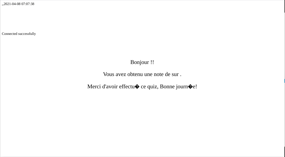

Hello,
I am new here and I am using a php script to extract data from a pdf form (the submission into html form is configured using adobe acrobat pro).
My problem is that my php script is not extracting the data. I am sure my php script is right because it was working on another website. So I am wondering if it has here the permission to extract the data ? Of course I ticked all the box marked read/write/execute. Or maybe my account is not fully functional, it is a free account or something else I am not suspecting. My php script is running cause I got the writing posted except the variables of the data that should be extracted.
Thank you for your help!

My account user name is epiz_28335387, my url is interactive-online-math.rf.gd and the url on the pdf form submission button is http://interactive-online-math.rf.gd/exportdata-dev1-9g5-h21.php.

I don’t see a way to upload a pdf on your website. How it is supposed to work? Can you send a video?
What I see:
Thanks!
Hello Greenreader9, I sent a pdf form to my student they fill it with the answers ( I am using acrotex so they can give mathematical answers) and at the end they have a submission button to send the form in html to my website on infintyfree where I have a php script that can read the data send them to mysql and display ithe result for the students. I put the pdf form in my space but maybe it is not visible for you and I can’t upload it here cause I am a new user.
One thing I’m not seeing in your code is error handling. Most database connectivity code has some kind of error catching, like making sure that $query->execute() actually returns true and not false indicating the query failed.
Hello Admin, thank you for your answer. I have error handling I just cut it to give the essential information on my script, if you check the link I provided http://interactive-online-math.rf.gd/exportdata-dev1-9g5-h21.php when displaying my script it indicates connected successfully.
My problem is that the script didn’t extract data from my pdf form and I don’t understand why ? I don’t know also if the link I add to my submission button is right,

In any case, I don’t think this will work here. After all, we provide website hosting, not some kind of data hosting platform. And this security system will prevent you from doing so:

What I was trying to say is that our servers have a security system in place which ensure that websites hosted here can only be accessed through regular web browser. Sending data programmatically from other places (including your PDF scripts) is not possible.
After all, we provide website hosting, not database hosting.
The article I linked to explains more about this.

Use a different hosting provider maybe? Our premium partner iFastNet doesn’t have a system like this on their paid accounts.
We can’t provide the service you’re looking for, I’m sorry to say.
