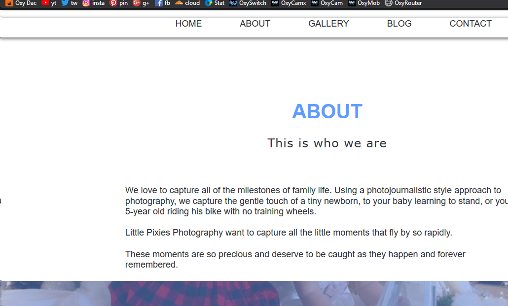

so originally there’s a carosel photo album thing thats on the very top – now its not showing with the HTM file
oooh - so i gotta go change it back in the naming on Open Element!!

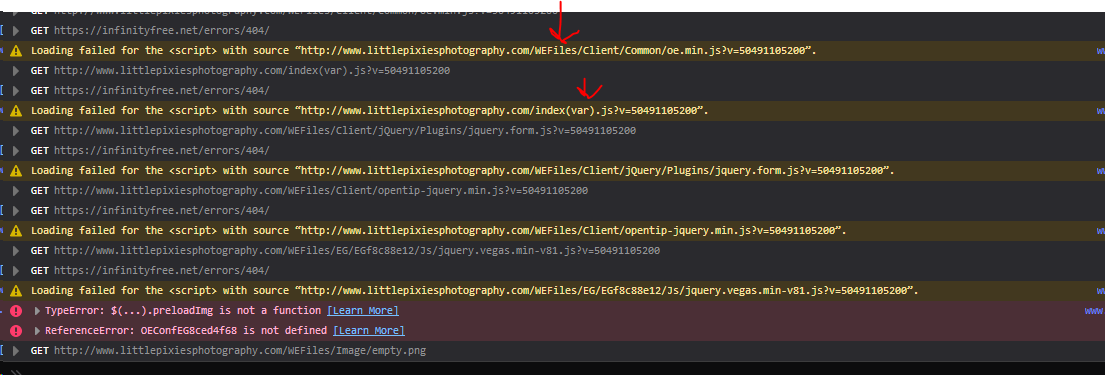

how do you open that page to see the errors?
thanks man, you da bomb - thanks for helping!
NP and YW
F12 - browser dev.console or network card (plus refresh F5)
Unix based systems are case-sensitive
it would be best to sit down and take everything in lower-case and slowly adjust part by part, directory per directory, names. etc.
